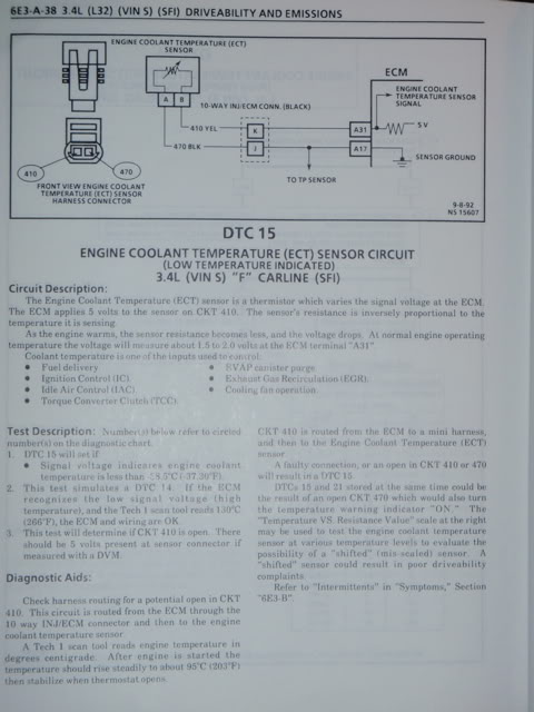

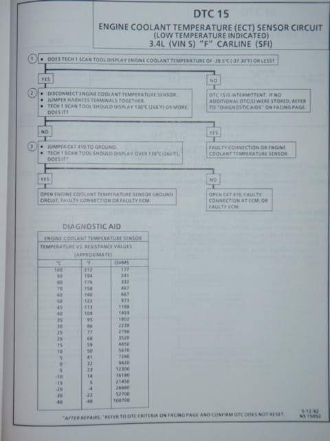

Old Jun 6, 2013 | 09:04 PM
Posts: 22,022
