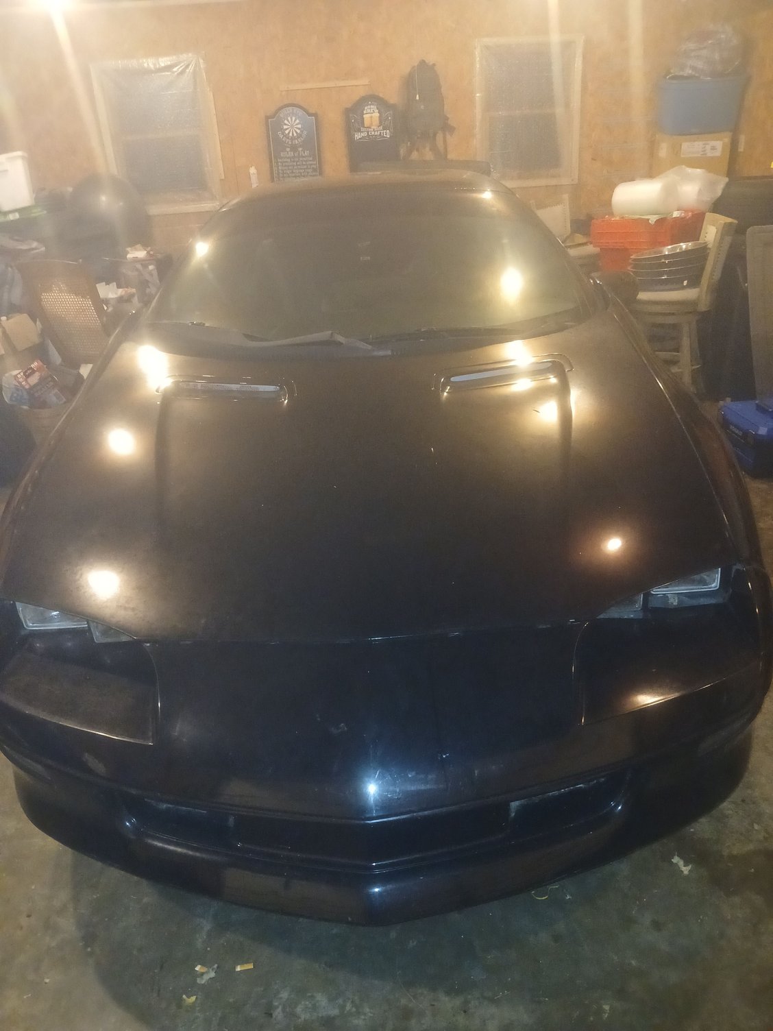

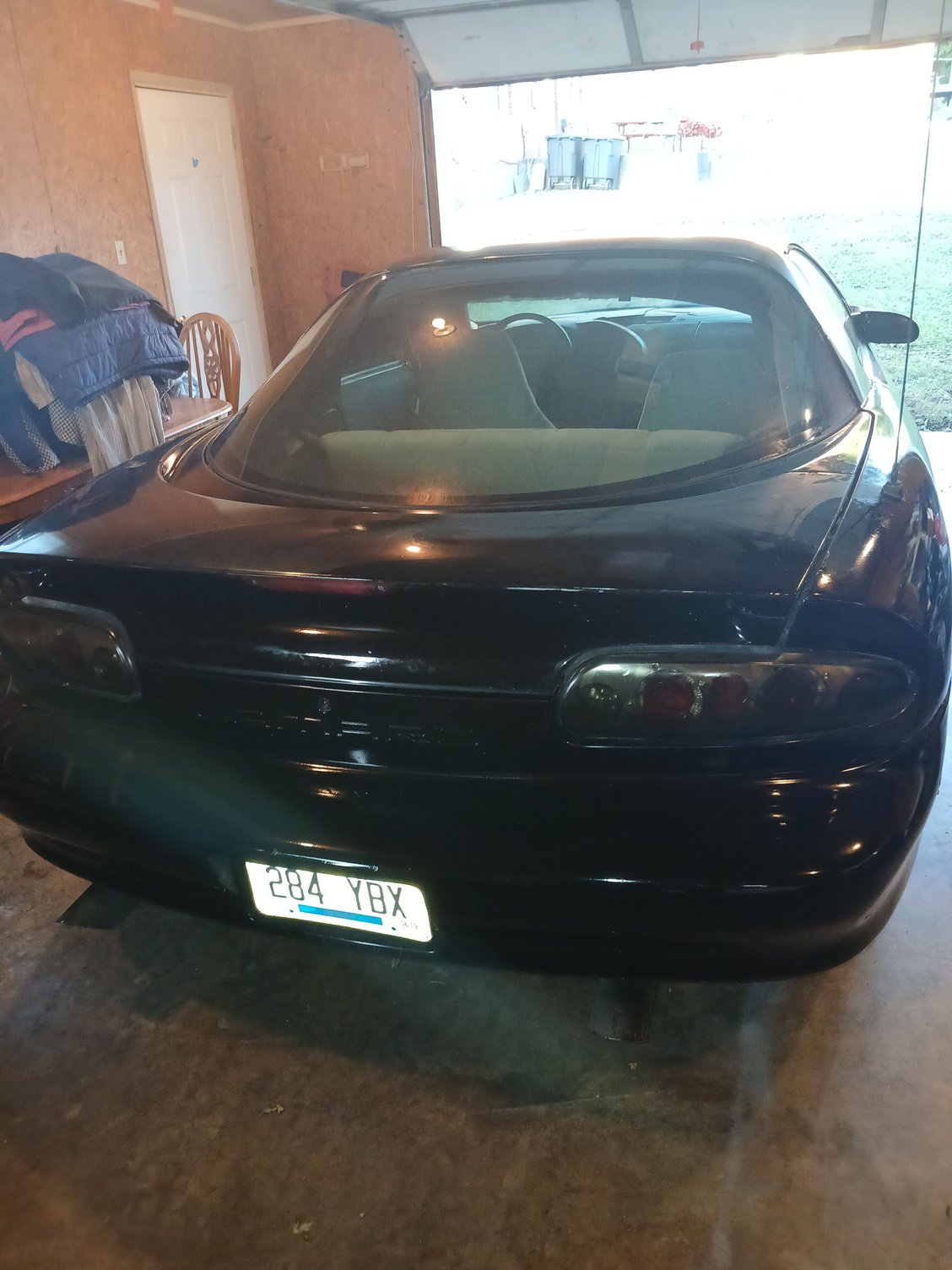

I suppose the next step would be to replace the PCM. We have an S10 in the garage we are building to take to our local drag strip; after that project is finished I can put the camaro back in the garage and drop the transmission to get a better look at everything if the PCM does not resolve the issue. Any advice or ideas are very welcome. I will keep the fourm updated on any solution I find. Here are some pics of said car. Its a beauty 😍 also forgot to mention it is an automatic 4l60e.
