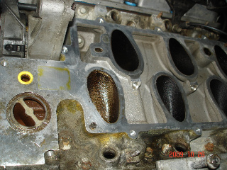

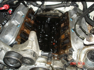

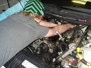

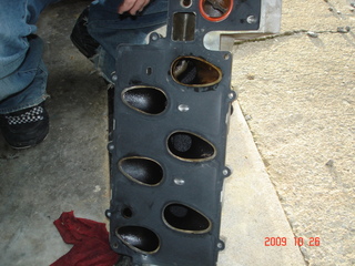

Finally getting around to the head gaskets. Here are a few pictures of the UIM and LIM removal. Hopefully tomorrow, we will be able to get the heads off and run them over to be checked out. Going to go ahead and have the valves done and put in new lifters while we have it down. This is the engine we bought back in the summer and have had issues with coolant lose. My first time replacing head gaskets, so fingers crossed and hoping everything goes smooth. Not sure I am going to put the rear engine lift bracket back on, that was a PITA to get to.
First pic is with coil packs, fuel rail and harness removed.
2. Looking at bottom side of UIM
3. Top of the LIM
4. My son getting to the stuff a short person can't reach!
5. UIM and LIM removed.

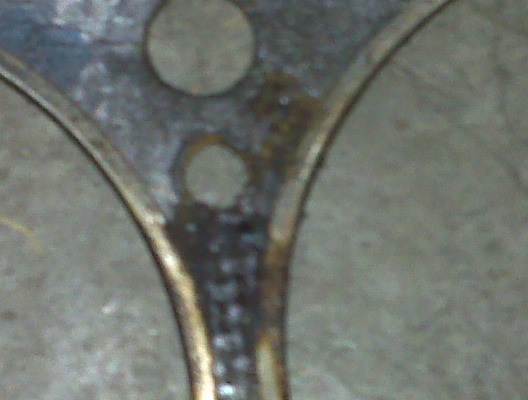

Got the heads off today. Clearly visible that the head gasket was needing replaced. Black crispy gasket and black marks on the gasket leading from the water jacket to the cylinder.

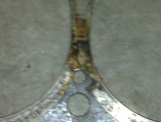

Here are a couple pics of the head gasket. Not what I was expecting. I was picturing part of the head gasket being totally gone but you can see where the water was running from the water jacket into the cylinders. This is a pic of the same head gasket from both sides. Hopefully tomorrow I will get the heads to the shop. Been trying all week but work has been keeping me on the road. PIcs are not that good, taken by blackberry. Thanks for the heads up Gorn, making my list out so I don't forget anything. Need to find out the size of the thread chaser to clean the block head bolt holes too before I go.
