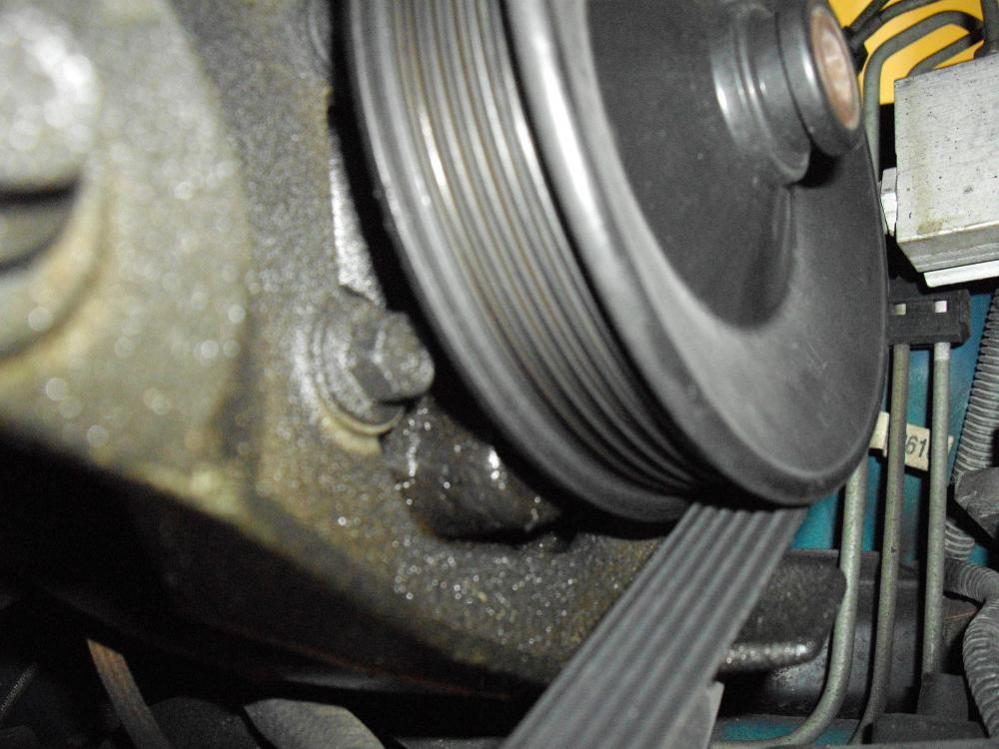

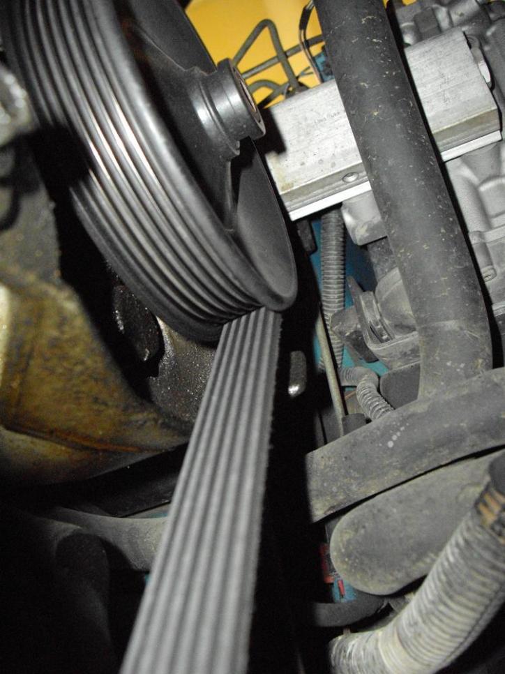

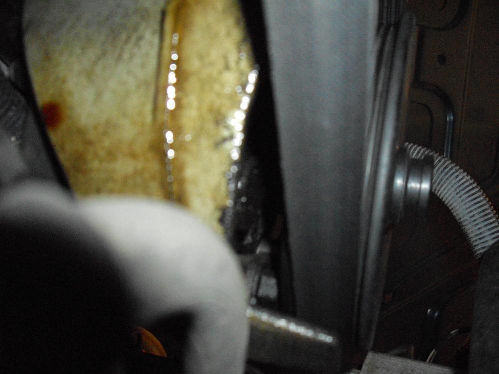

i have a 95 3.4 manual and i was looking to replace my crankshaft position sensor (which im guessing is behind the big pully with the 4 bolts) when i discovered this leak
before i go into taking everything apart to find out that i dont have the tools to fix the problem i wanted to know if it would be as simple as tightening a bold or replacing the gasket?
sorry about this noob Q but im just getting frustrated with this car
Attached Thumbnails oil leak-imgp1130.jpg   oil leak-imgp1131.jpg   oil leak-imgp1132.jpg
Old Feb 11, 2010 | 07:46 PM
Posts: 22,042
well it could be coming from the intake manifold or one or more of the front cover seals, which include the front crank seal. are u losing alot of oil?

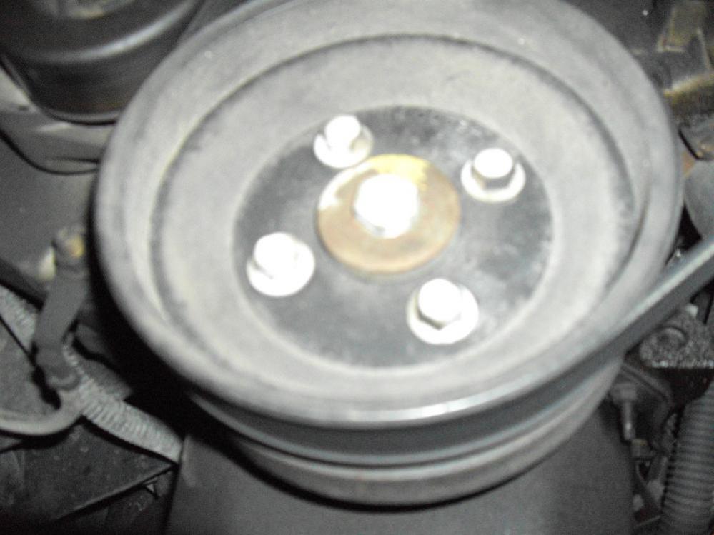

also can anyone help me find the crankshaft position sensor?
is it behind this pully?

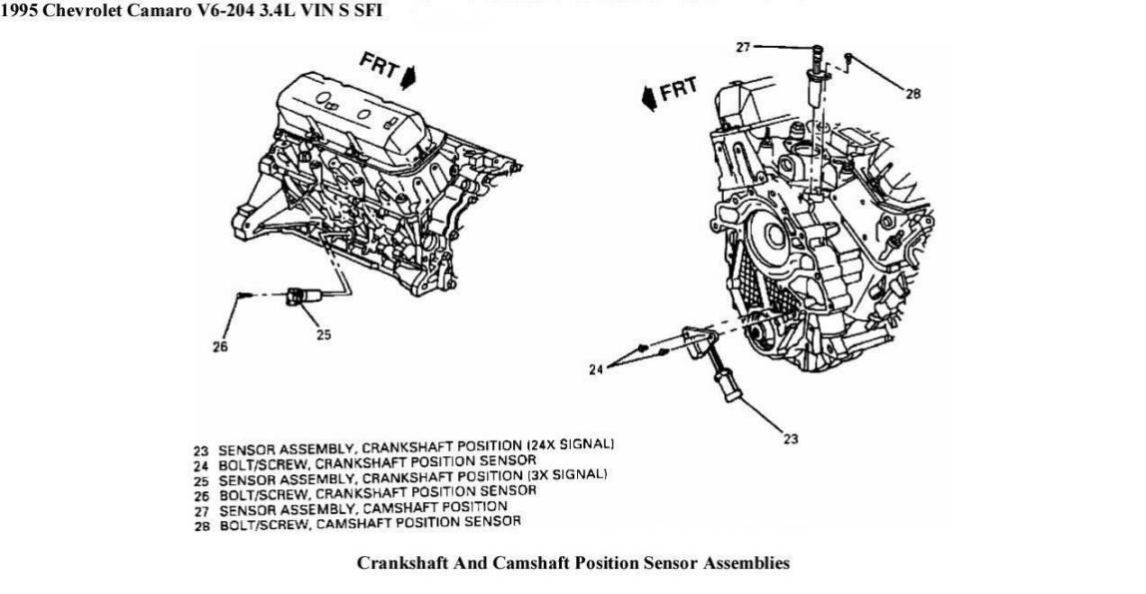

i found this but im feeling like the whole front of the engine is gone in this image
Old Feb 11, 2010 | 09:28 PM
Posts: 22,042
ok cool its shown to be on the other side of the crank pully. can u see it back there on the topside?

heck i just looked at the other pictures a little closer and they are of the power steering pump arent they. i would adjust my post to say its most likely the front seal on the power steering pump and u need to start looking for one. sorry bout that.
