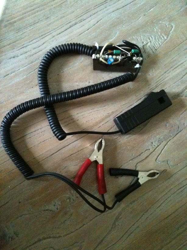

I have a scope and I built a module to get spark signal.
But the problem with this V6 engine is to get signal on the spark plugs. It's easy to have it from the coils but not at the end of the wires because it's under the exhaust pipes and the only access is under the car.

It should not matter where on the wire you hook up the scope. Since it is all one circuit a a defect anywhere in the circuit will show all along the circuit. There is a finger print that a secondary circuit makes. Even at the coil you can tell if a cylinder is lean or rich. How long the plug fires and the amount of power it takes to fire a cylinder can tell you a lot about the circuit. In your case since you do not have the training you just need to see a difference from other cylinder. If the scope you are using is not designed for car you will need to get it adjusted so you can see the proper wave form.
I have a china made scope that hooks to a lap top that works good but I did not trust the digital pattern so I hook an old scope I used to tune antennas. Getting the setting right on the standard scope was kind of a pain. I think I found something online to guide me.

My scope is an old Tektronix 453 and is working very well to repair antic radios and TVs. My trouble is not with the scope but with the wire to pick up the signal. I don't know if I need to put a coax or a single wire. With the single wire hooked up, the curve is full of parasites and with the clip taken from a strob the signal is low voltage.
