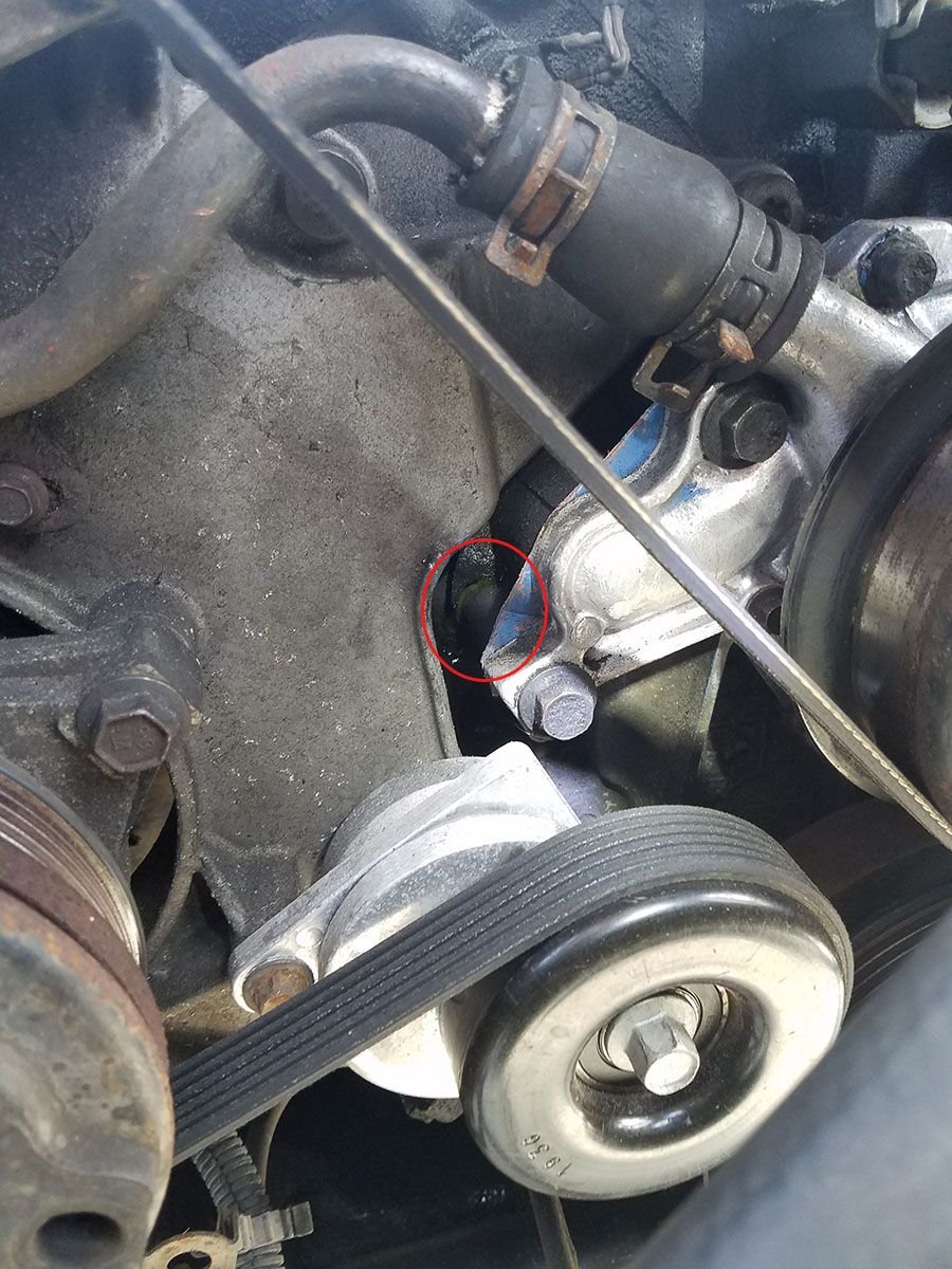

A quick update to this. I pressure tested the cooling system, and the leak has gotten worse and is behind the wp. I've got some pictures.... I'm trying to figure out how to identify which component is leaking. Does this look like it could be the timing chain cover gasket? I've read the 3.4L has (lower?) manifold gasket issues as well, where would evidence of that usually be present?

Posts: 139
Is that a 3.8L or 3.4L?
It seems to me it might be the timing chain cover... I think you can actually see the gasket for that back in those pictures. It just seems to always be some kind of coolant leak with this car.

Posts: 22,027
its 3.8 for a 2000. engine is from a 2006 la crosse that i stripped and put all the outer suff from the 2000 on it.
