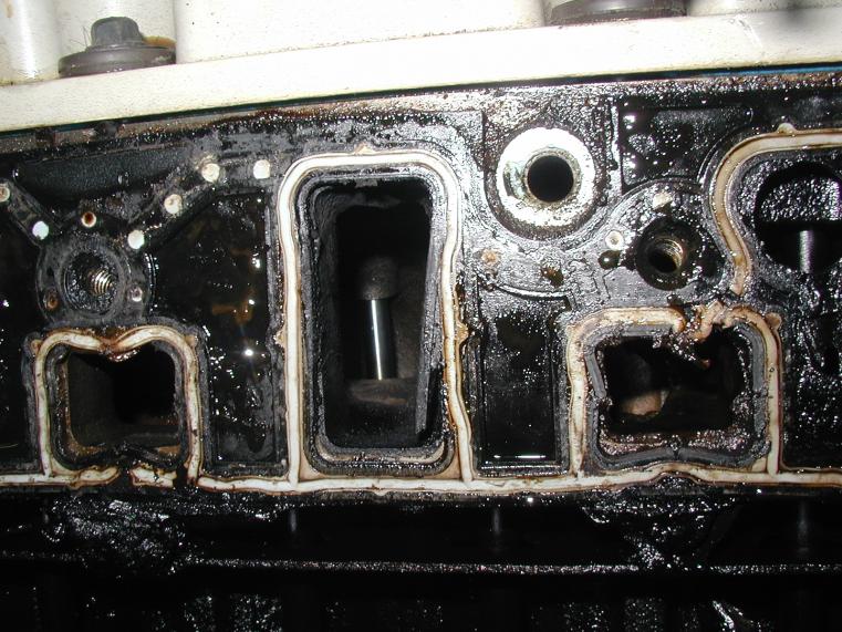

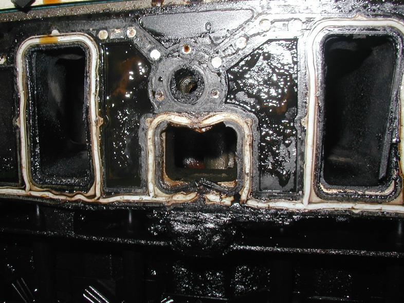

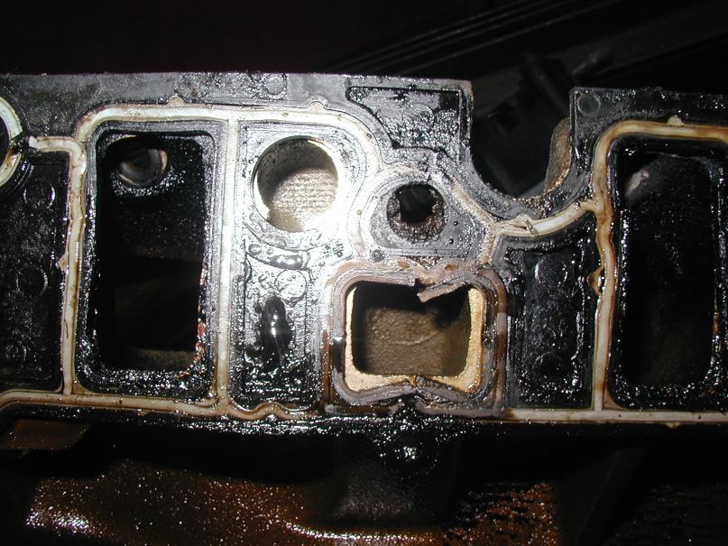

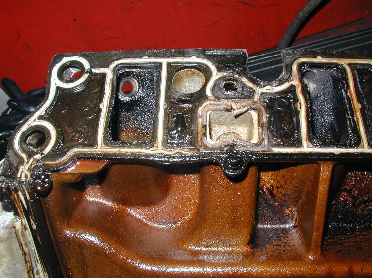

i had a similar situation with my LeSabre and it was the lower intake gaskets. it's a known problem.
Attached Thumbnails Disappearing Coolant-p2230020.jpg   Disappearing Coolant-p2230021.jpg   Disappearing Coolant-p2230022.jpg   Disappearing Coolant-p2230023.jpg

I will post my end results in a few weeks but I did my intake gaskets Wednesday and they looked very simialr to the ones in the pics. I also had coolant disappearing. I have to say this is a beast of a job to do. I started a 8:30 in the morning and did not finish until about 7 that night with only one hour long lunch break and one 45 min trip to the parts store. For anyone thinking of doing this themselves. Figure about $125 between gaskets, oil and antifreeze. If you pay to have this done figure on about $5-600
