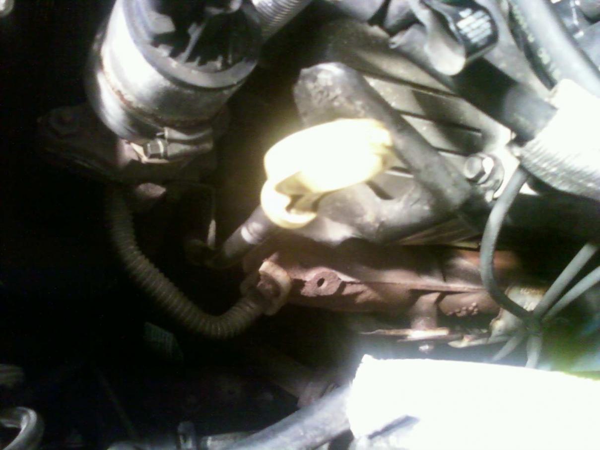

The engines are the same Camaro and Firebird. I think what you are seeing is the change of the exhaust manifolds. The 99 is the last year for the crappy cast manifolds. 02 would a header like exhaust manifold.

Yea I think Gorn you are right. Because I had a better look at his today and realized the exhaust manifold was the difference. It is more spread out and lower than the plugs. While on my camaro it is very compacted and above the plugs. Also his doesnt have a heat shield.

Default Here are pics of my camaro engine
Notice the manifold and how you dont see any spark plugs.
