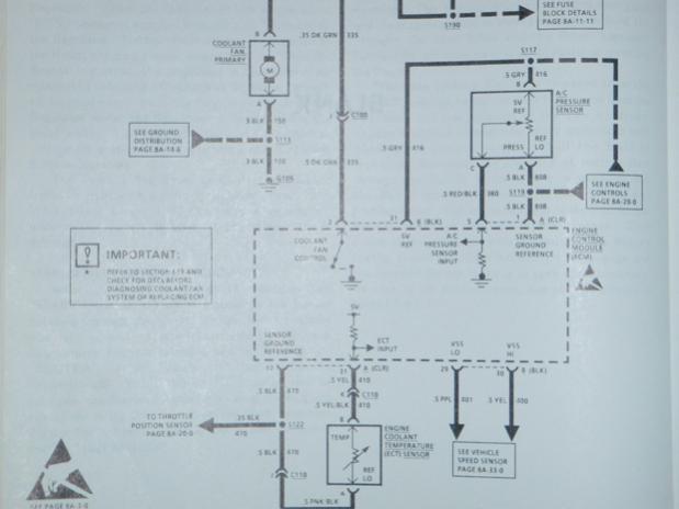

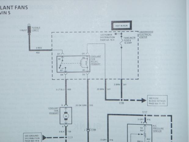

Old Aug 10, 2009 | 01:33 PM
Posts: 22,040
this is from a 93 dealer service manual. shows blue wire is the hot side of the connection black is ground. run 12 volts to the were the blue wire would go and ground the black. fan should work if its good,.

Old Aug 14, 2009 | 11:43 AM
shredderphil85's Avatar
Joined: Jun 2009
Posts: 5
From: Charlotte, NC
well I supplied power to the fan to test it out and the fan itself definitly works. At this point just about the only thing it could be is a bad coolant temp sensor. I found one of the temp sensors, the one up top near the thermostat housing. Where is the other one at, and which one is which? I know that one sends signal to the fan and the other to the temp gauge.
Old Aug 14, 2009 | 11:52 AM
Posts: 22,040
on the 93 they show one on the intake manifold (temp gage sensor) and one in the head in the front on the driver side (temp sensor) this is the one u want.
