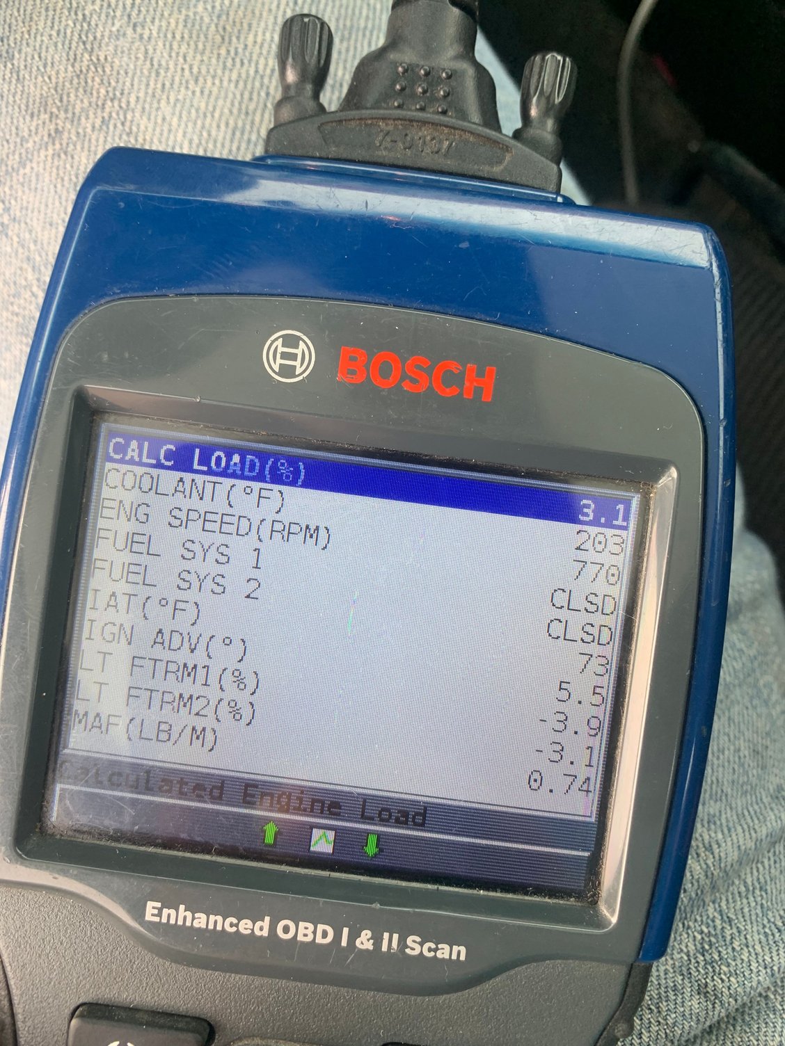

Last Night I pulled the injector rail up a little and checked to make sure I didn’t have a leaky injector, while I was putting it back together I noticed I had #2 and #5 wires mixed up. Since there on the same coil You didn’t even notice a miss at idle. It seems a tiny bit better it doesn’t chug now it just sound as if the choke is on but it will rev fine all the way to 6k as long as you don’t put your foot in it hard. So the StFt is more than likely inaccurate since I think it was hooked up like that when I took it there.🤬🤬 I’ve only had the wires off about 15 times now and must have messed it up when I swapped back to the stock ICM. It has an idle surge now when your coasting tho. It will fluctuate between 1100- 700 rpms but stops soon as you come to a stop. I Unplugged the MAF and it runs exactly the same. Waiting till orileys opens to use there scanner and see if the StFt changed. But the surge sounds just like a vac leak surge but I don’t understand why it only does when I’m coasting. It does it a little when it’s cold but then goes away.. I think it’s making me crazy 🤯🤯

I noticed MAP seemed low at idle
I tried unplugging the MAF and there was no change. But I did notice the MAP was very dirty when I took it out so I cleaned it but never replaced it.
Old Sep 22, 2019 | 09:51 PM
Your vacuum is reading to low to being at idle. I would verify that with a vacuum gage, The MAP sensor itself could be fine but something else could be causing the issue. If you check the vacuum the the meter reads 12 HP but the hand help gage reads18 they you could have a problem with the map sensor.
