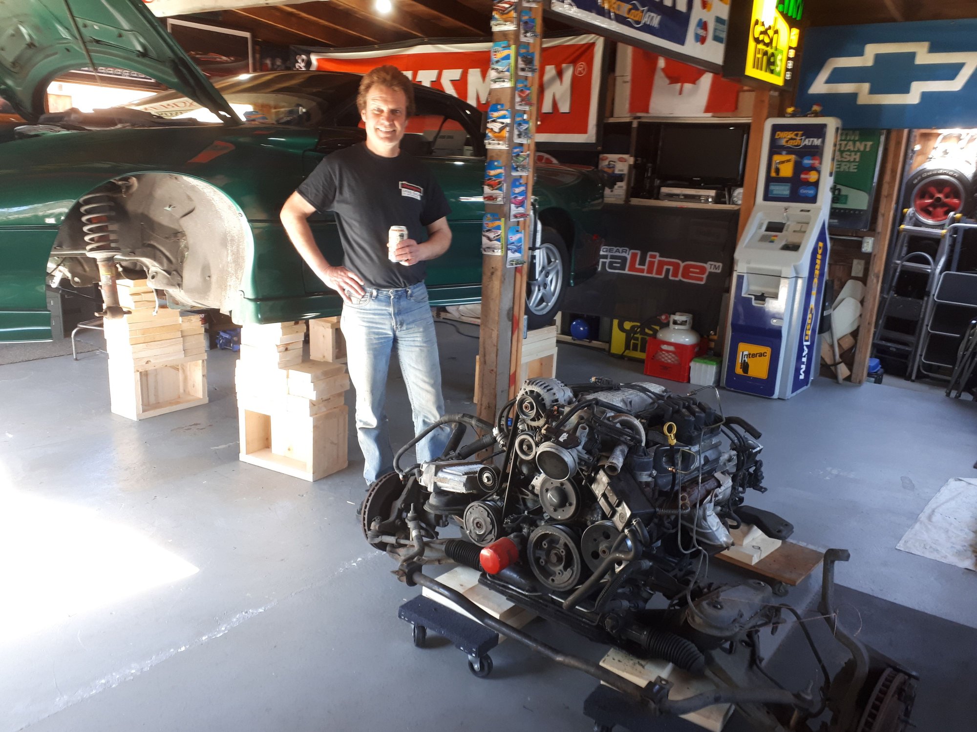

Things are beginning to move along, although at a slower pace, as I am doing this solo due to Covid 19. Engine is now out.
pretty straight forward, using nothing but standard tools and a floor jack.

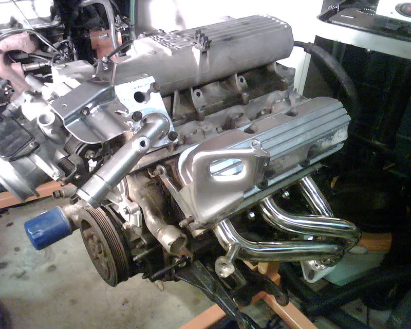

Bring back some memories, It was 10 years ago for me. Got get some headers the stock manifolds are just the worst.
https://camaroforums.com/forum/attachment.php?attachmentid=41260&stc=1&d=15867952 34
https://camaroforums.com/forum/attachment.php?attachmentid=40264&stc=1&d=15867949 46
