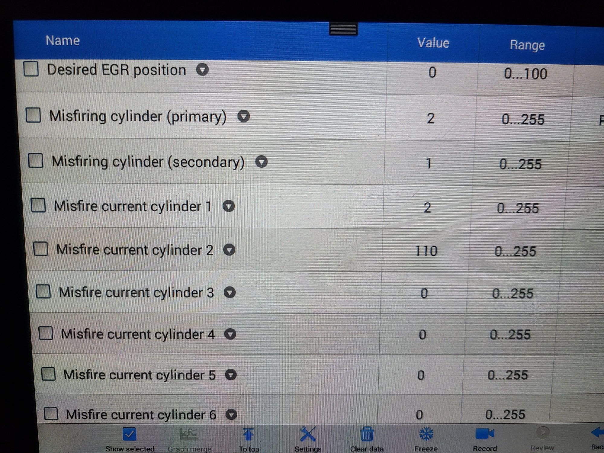

Rebuilt a junk yard motor and had a constant #2 Misfire since fire up, see pictures

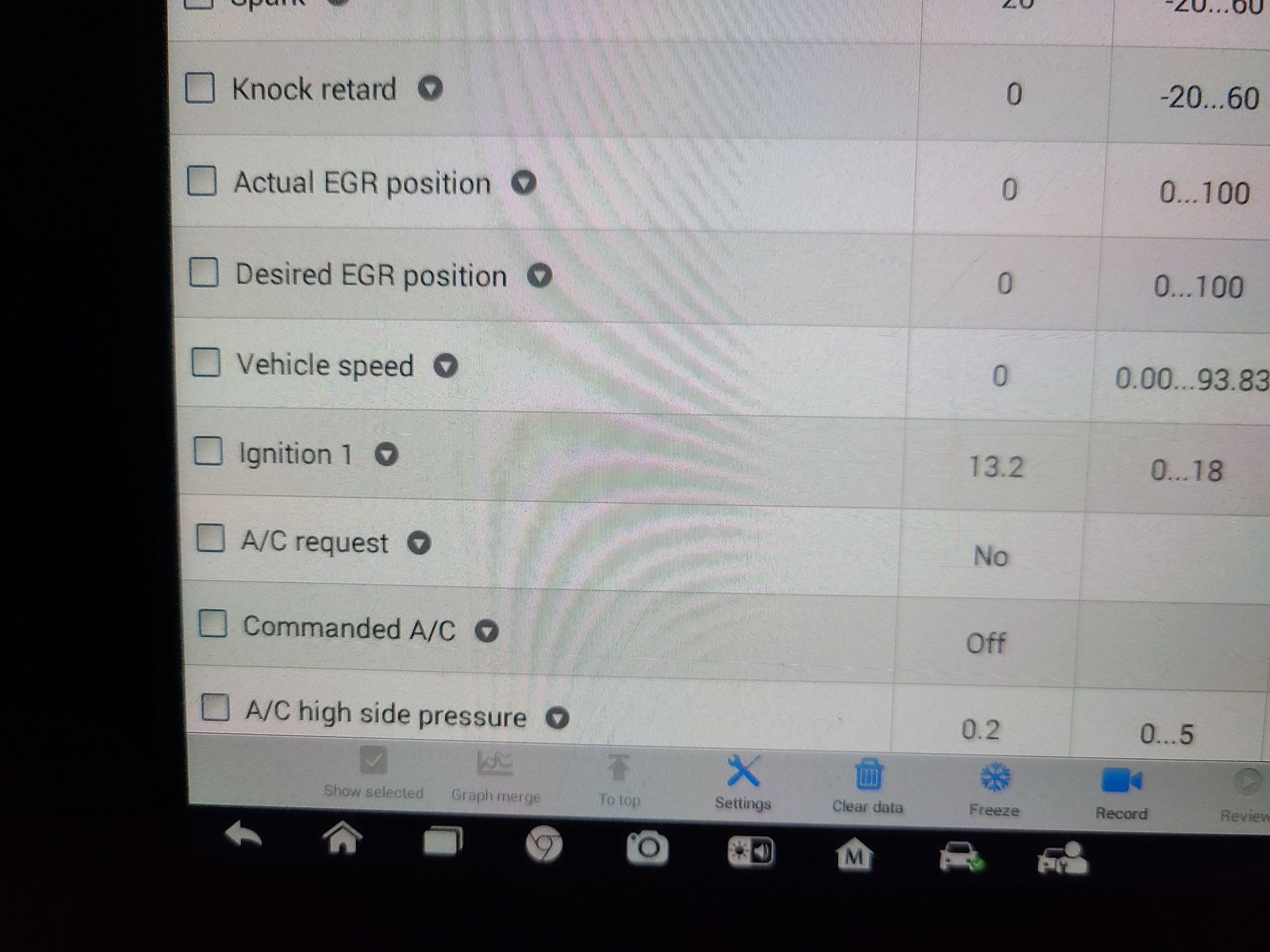

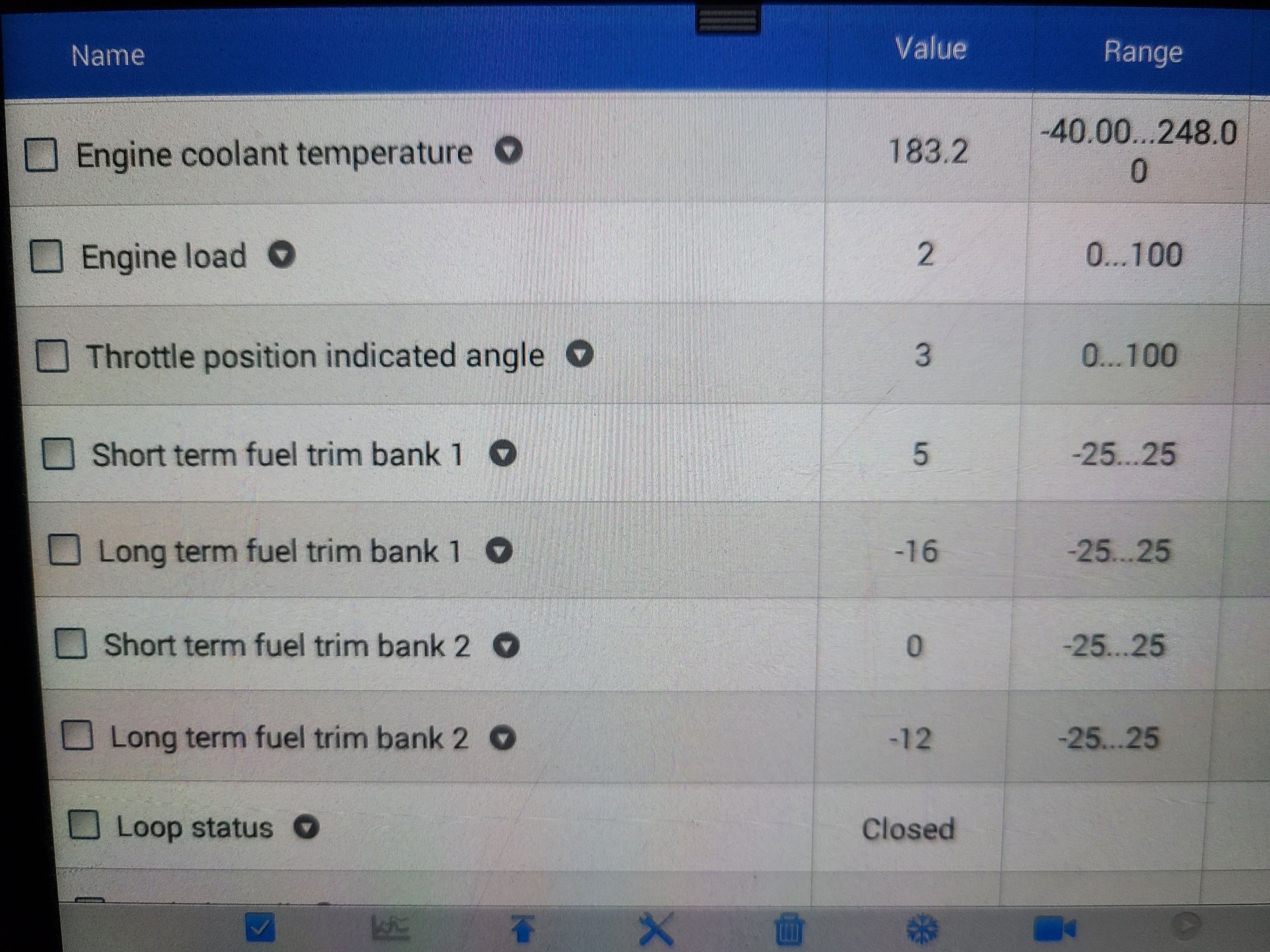

Everything looks correct...any help would begrateful
