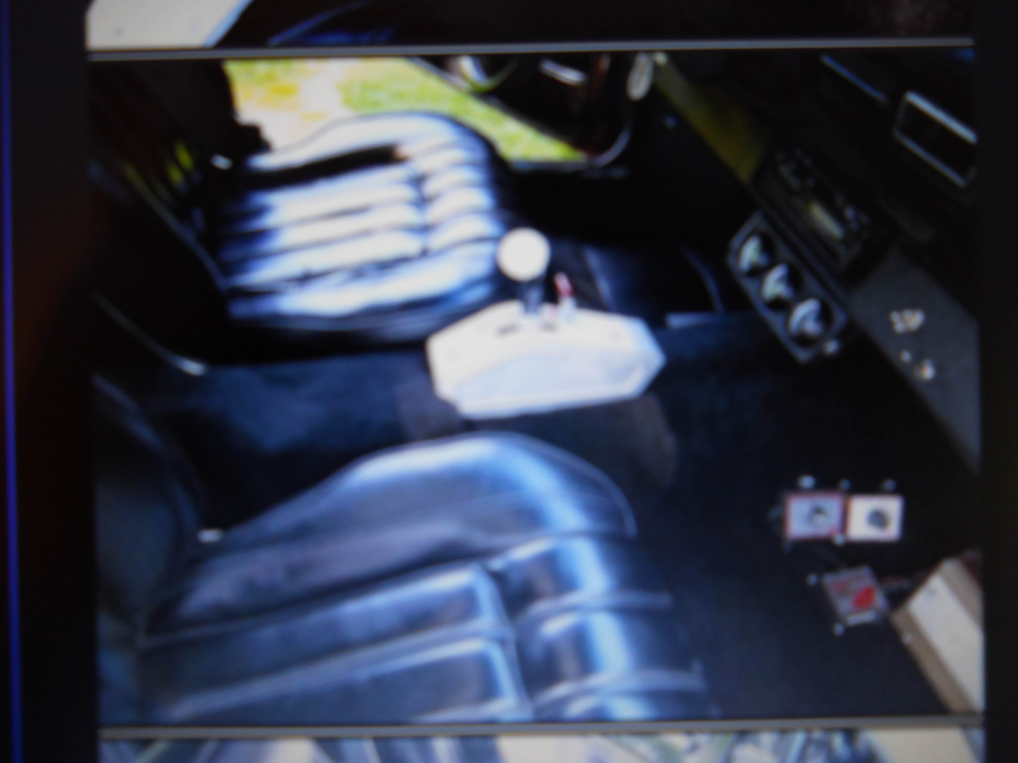

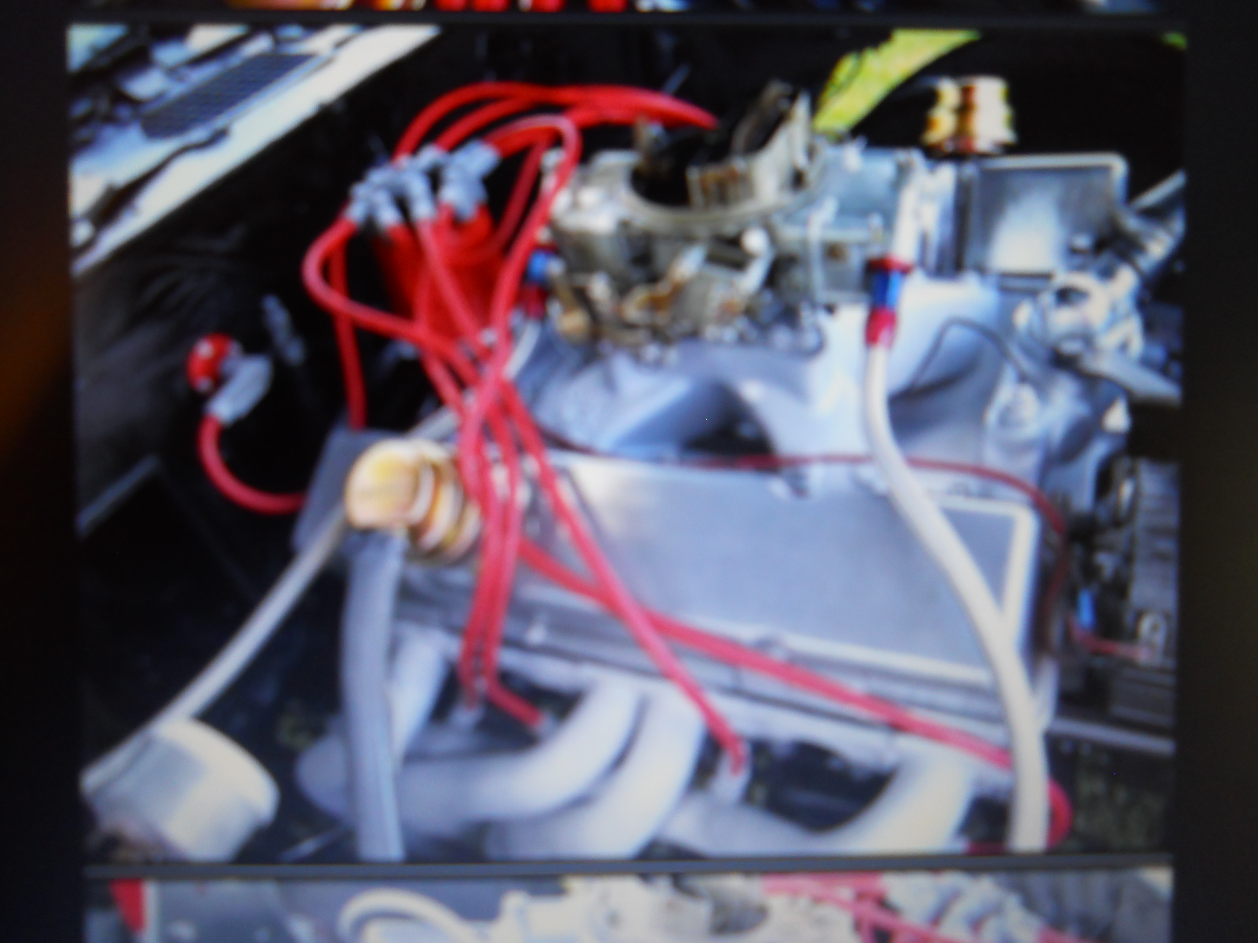

Default pics
,I am kinda kicking myself ,there is a 74 z28 on ebay right now that was a drag car now pro street ,with a fresh 383 ,leather inside the car is a full resto ,new paint 456 Detroit locker ,an the kinda set up I want one day ,looking back this car $7995,00 guy has 100% feedback an if the pictures are as true as when I bought the one I have now what a deal ,only thing I see needs upgrade is to serpintine belts pulleys ,I wish I had the money ,I would drive out an look at it ,its a sweet car yellow an black,but to compare the 74 to his ,just as ready for the track ,I got to say what a buy ,but not all guys are looking for a prostreet car I could love it looks mint an new ,so I guess I would rather own 2 or 3 old ones then one new one an for less money to ,if you shop there are some great deal out there[/QUOTE]
56,000 miles few pics bad but can see the whole car is like even has sunroof
