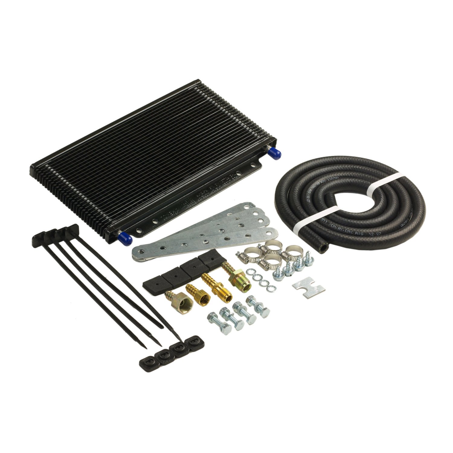

Also going to add a stacked plate aluminum trans cooler: the B&M 70264 which is 24000 GVW… Who knows why the factory did not include one stock -- dumb.

Cooler arrived monday & is almost installed, Yank tq converter arrived yesterday, and tear-down resulted in finding:
