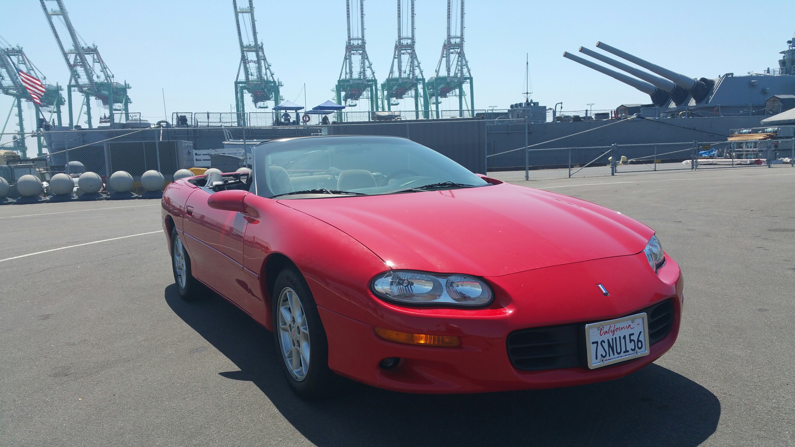

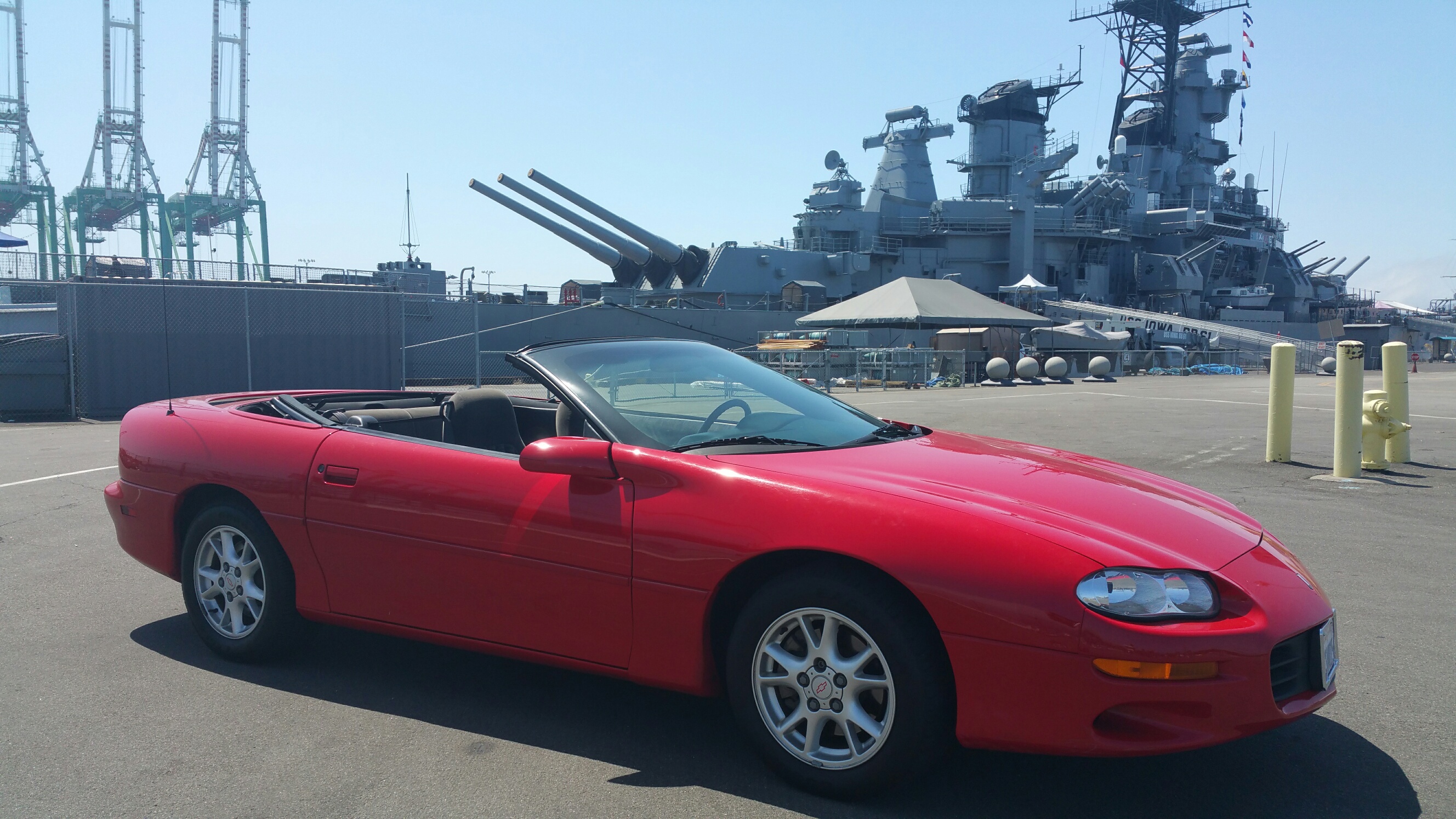

Hi guys,
Looks like a very cool forum. A lot of information available that i have been digging through. I ran into a 2002 V6 Base convertible last year with 32k orig miles on her. Picked her up real cheap and even though she was mint, i started bringer her back to the 20th century. I did all the basics to get some more performance, and am at a cross road on what to do next.
Intake
Cat Back exhaust
MSD ignition
Coils
Plugs
Ultima
Ground kit
3.73 and posi install
Hypertech tune to fix tire size etc
I am thinking about possibly a port/polish with possibly over sized cams etc.
Turbo is too much, i don't believe i will go that route.
Anyways, Whatever your recomendation is, if you could please referance where you would take your precious gem to do it in Southern California.
I am in the San Fernando Valley, thanks for any info!
I uploaded some before and afters.
