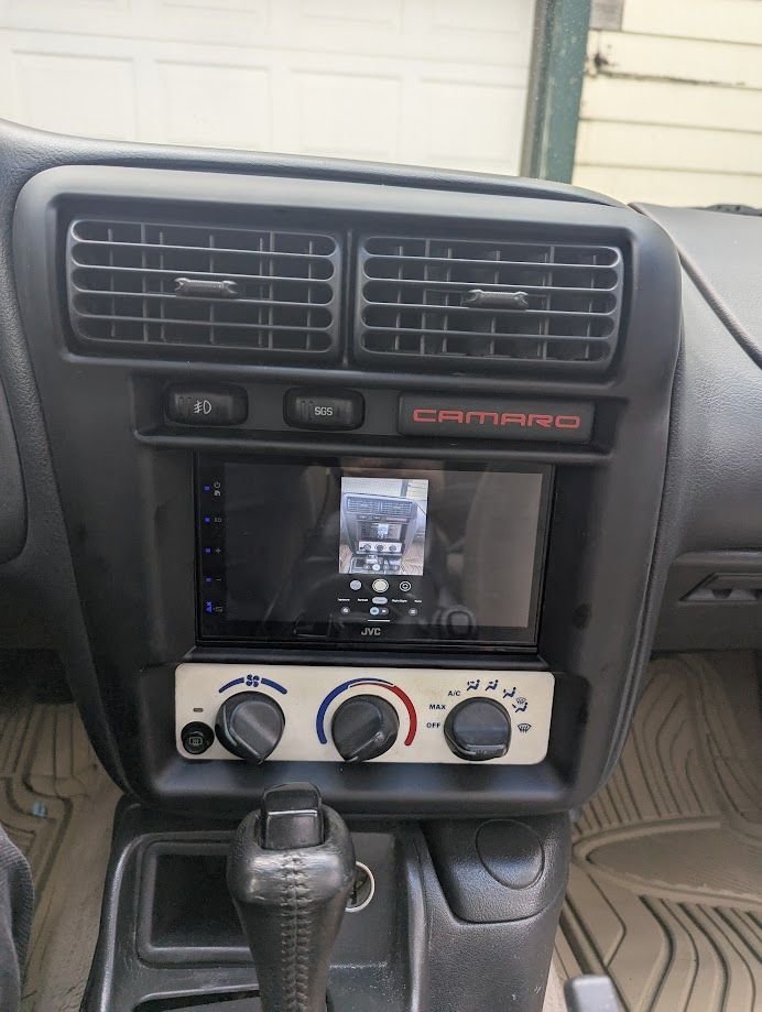

Replaced the loosely tossed into the dash opening stereo with a properly mounted on with Bluetooth

Replaced the offensively white HVAC panel face with a black one to match the rest of the interior

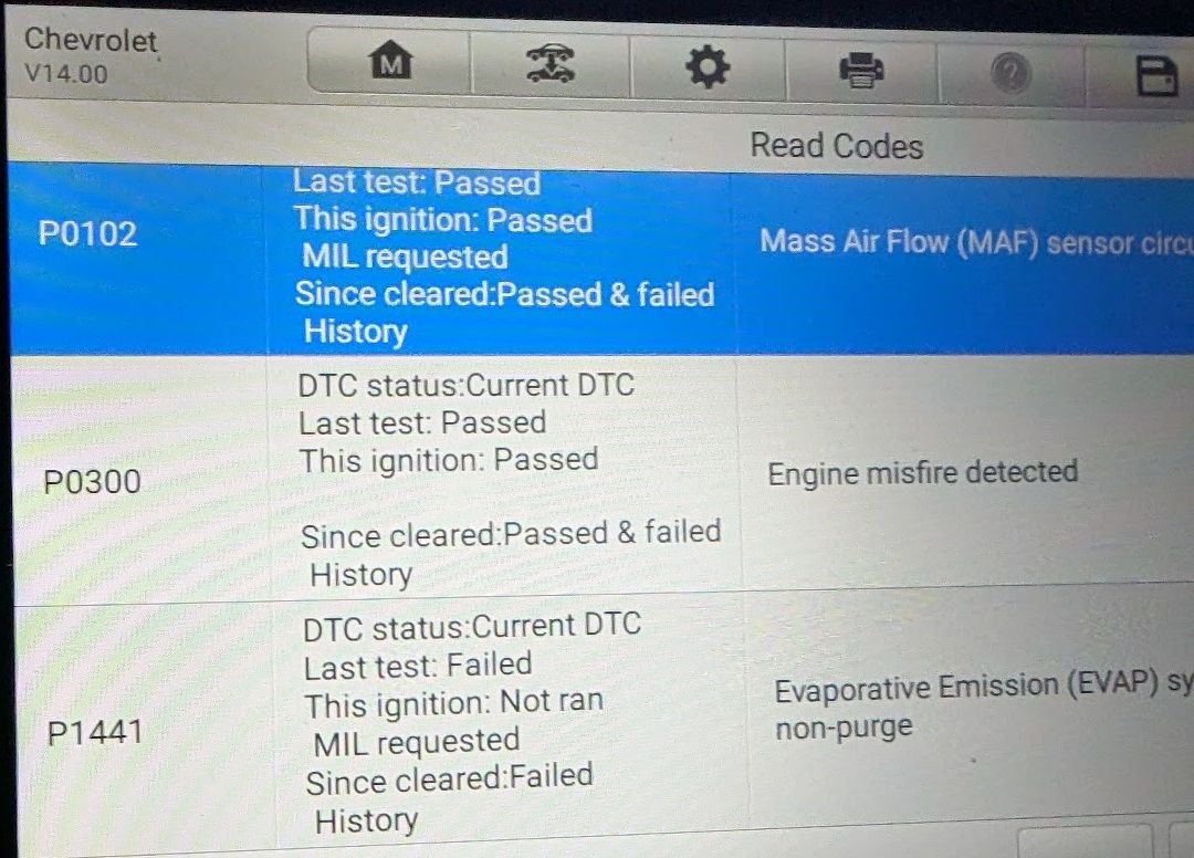

This set of fixes cleared the three codes lighting the Check Engine light
The MAF replacement cleared the MAF code, the Evap tubing also made idle smoother and more stable, and EGR replacement actually made it idle properly and stop blowing exhaust into the interior when stopped in traffic.
P1441 got a lot less frequent with replacing underhood tubing, but didn't go away completely until I fixed the rotted out hoses behind the left back wheel.

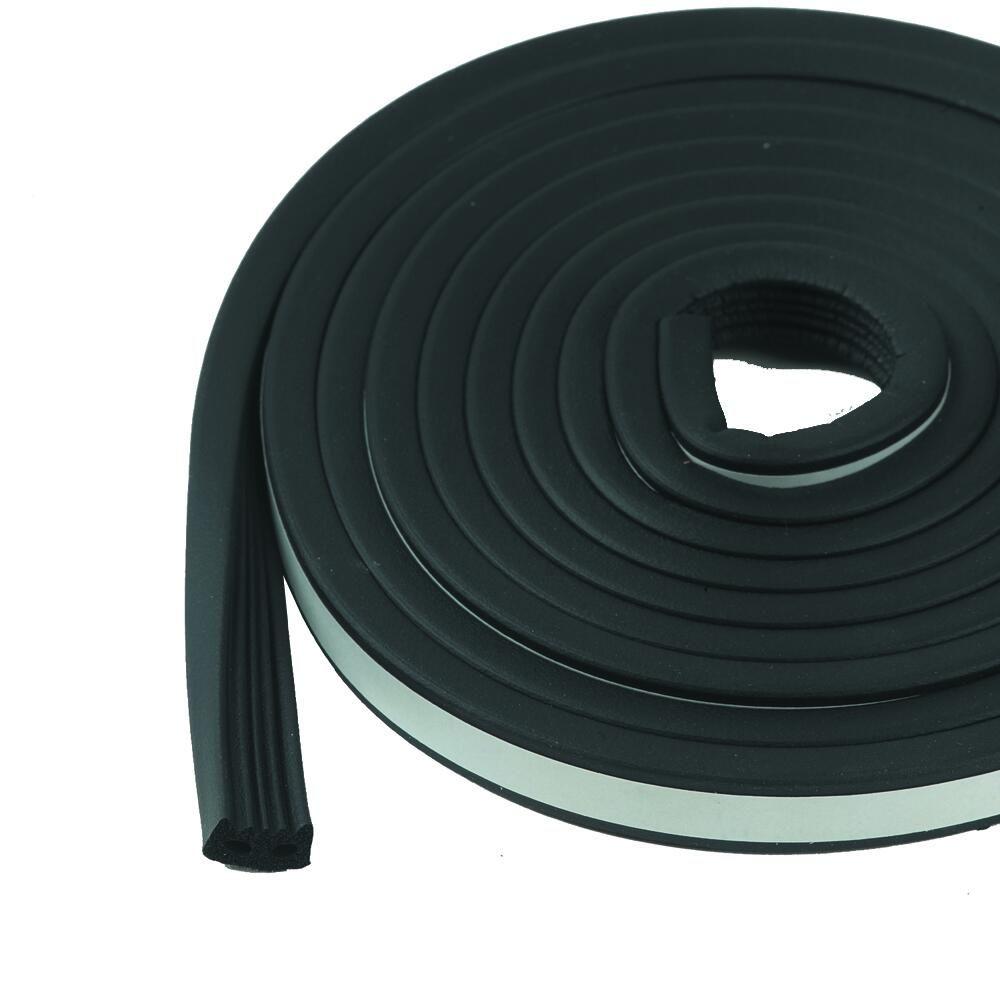

Also replaced the rotted foam on the underside of the cowling. It probably isn't super important, just some noise dampening, but still. BTW, this is pretty good stuff for that.
They sell it at home stores.

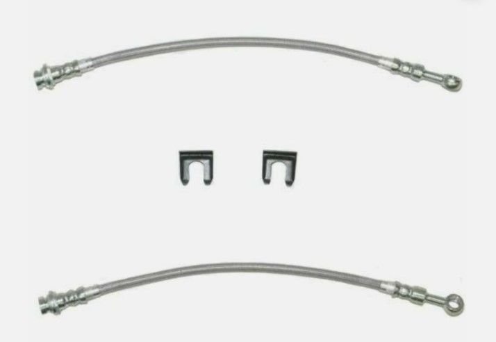

The hose thing came out of the fact that after replacing the pads and rotors I still had some dragging. This is likely why the old rotors were uneven. I had a similar issue on a different GM car, and the cause was hoses that looked fine on the outside, but swelled internally.
So, I put in braided vinyl-covered hoses. I usually do this on my bikes, too. 30 year old rubber isn't very good.
As a bonus, I discovered my brake fluid was pretty gross. Replacing hoses results in a flush anyway, and I flushed a little longer to get it clear.
I think the drag is fixed, and the braking is much improved. I know people talk about upgrading brakes and whatnot, but I feel like a lot of the improvement comes from replacing malfunctioning brakes with good ones.
