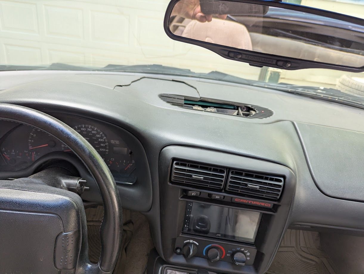

I had the classic Fourth Gen disintegrating dash problem.
When I first got the car I touched one of the louvers and it fell off. More fragile than the average eggshell. I quit touching it.

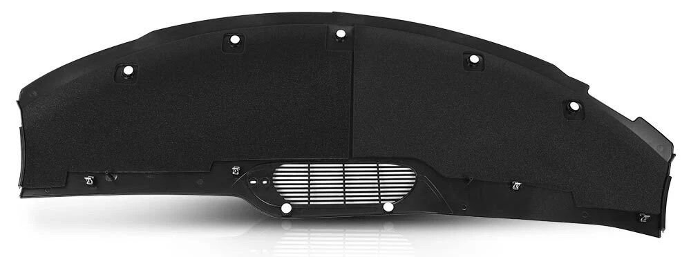

The dash pad showed up in a simple cardboard box. Despite that, it seems to have survived the shipping quite well. There are no instructions or anything else with it, just the pad in a plastic bag inside the box.
The pad looks to be a tiny bit thinner, but overall about the same quality as original. The black color is deeper, but I think that may be the original just fading. The foam padding is not as dense and does not have the plastic film on it like the original, but given that this is a completely interior piece and there is no moisture to guard against, I don't see how that matters.
The pad comes with the spring clips and with Velcro stickers.
The white dots are the paper backing for the Velcro.

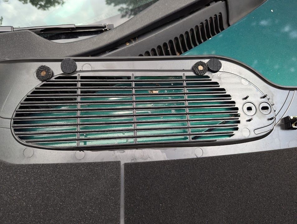

The thing about that is that the Velcro it comes with is pretty much useless. The original pad does have Velcro, but it is a different type, much coarser than the household grade Velcro dots on the replacement pad.

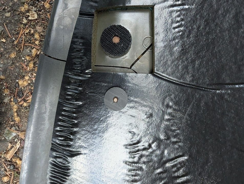

The OE velcro is on these plastic buttons held to the pad with copper snaps. The replacement pad has the correct mounts for these molded in. You can get at them by peeling off the cheap Velcro. It's really easy to do because the molding is cross-shaped and there is almost nothing for the Velcro sticker to stick to.
This is the front and back of this button on the OE pad. There are two sizes - the big ones for the edge near the glass and the small ones for next to the vent.
This also shows another important thing about the replacement pad. It does not come with the mounting for the security LED and the light sensor. It's this goofy plastic cup. It goes onto the four little pins you can see around the two holes and then the pins are melted to hold it on.
Fortunately my holder only had a small crack and I could reuse it on the new pad. I have no idea if it can be bought separately.

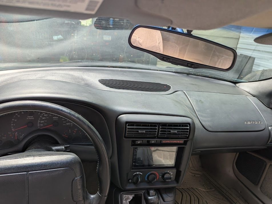

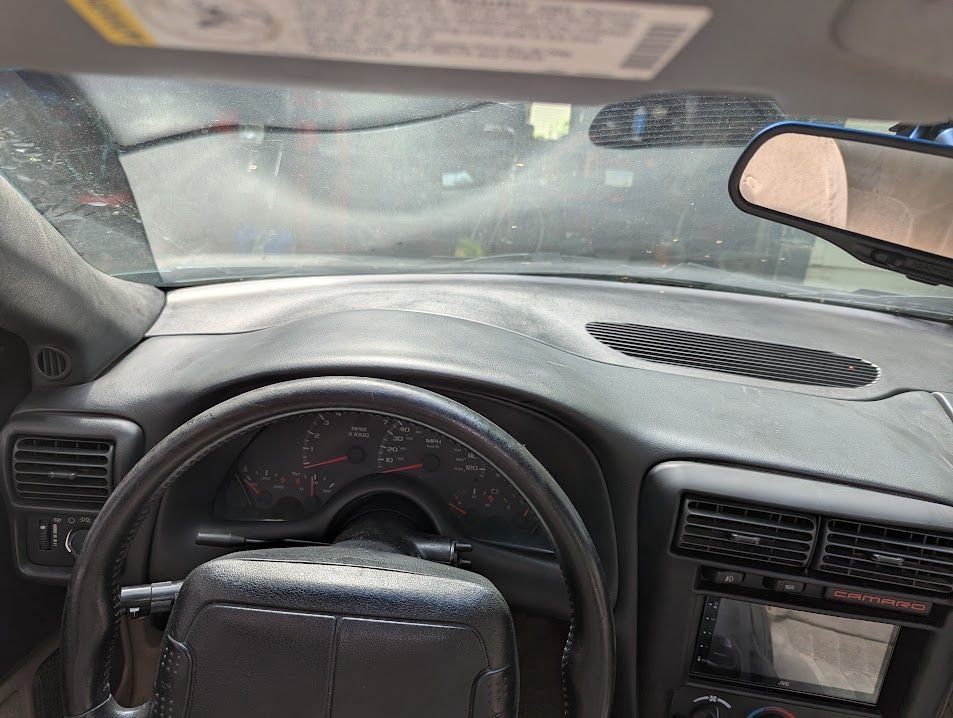

I think this is about as good a result as you can hope for. Definitely better than the cracked mess I had before.
