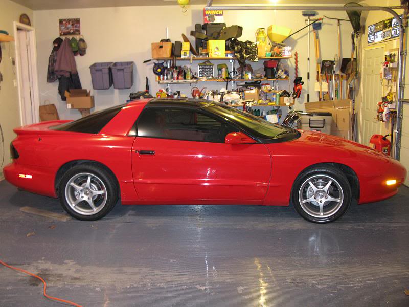

sorry bout the pic, this should work:
and Gorn, idk if we "drained" it, but it got charged just over 2 weeks ago. it worked just fine until this weekend.
Oooh do like!
