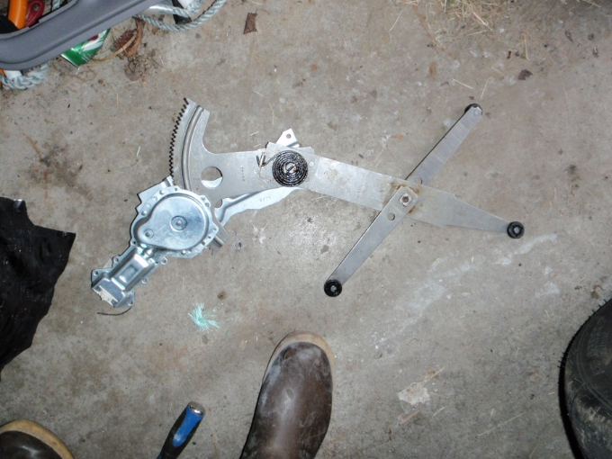

Thanks for that. One problem I am having with all of the materials I have viewed and read is the issue of exactly what the motor connects to. Yes, yes, I see the drill holes I made, I see the holes in the motor where the bolts go, perhaps showing my ignorance, what I never see is what surface within the door the motor attaches to, and, in a related issue, the relationship between motor and starting position of the gear on regulating mechanism.

window should be up all the way when you install motor. heres a pretty good recording

It mounts to the regulator frame, so that it meshes with the sector gear. This photo may help a bit.
