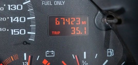

So, one thing that really bugged me is that GM for some reason made the odometer display red.
It's really annoying to see it out of the corner of your eye because red generally implies a warning light. So, I decided to re-color it.
The display itself is a transparent LCD. It is backlit with a standard clear bulb. The red color comes from a piece of plastic behind it.

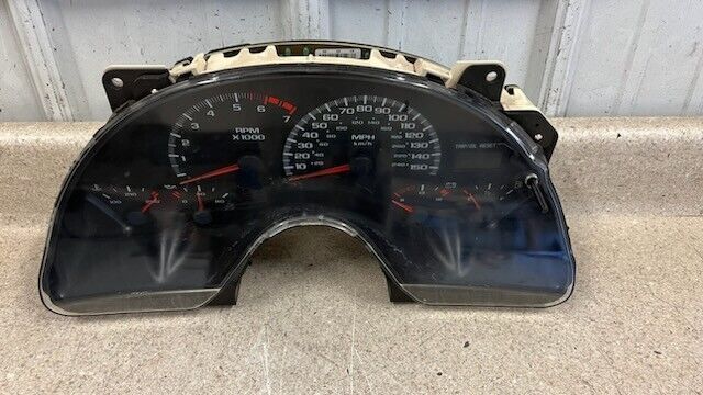

With the cluster out you should see the black plastic tabs that hold the lens on. They are easy to press just with your finger, and the lens will come off.
Don't lose the odometer reset stick. It is not attached and will just fall out.
The black overlay is glued to the plexiglas under it. If you look at the edge about where the tachometer is, you will see it. You should take out the whole thing, not peel the overlay. You can start prying under the plexiglas there and go all the way around a couple of times. Use a plastic tool if you are going to use a tool. I used my finger.
What you are actually doing is pulling the motors for the gauges out of the sockets on the circuit board. If you do it in a circle and a little bit at a time you should be pretty safe from breaking anything.
Once you pop off the gauges the odometer display will be left in the white shell. You can unplug it, or not. If you do unplug it, do it at the display end.

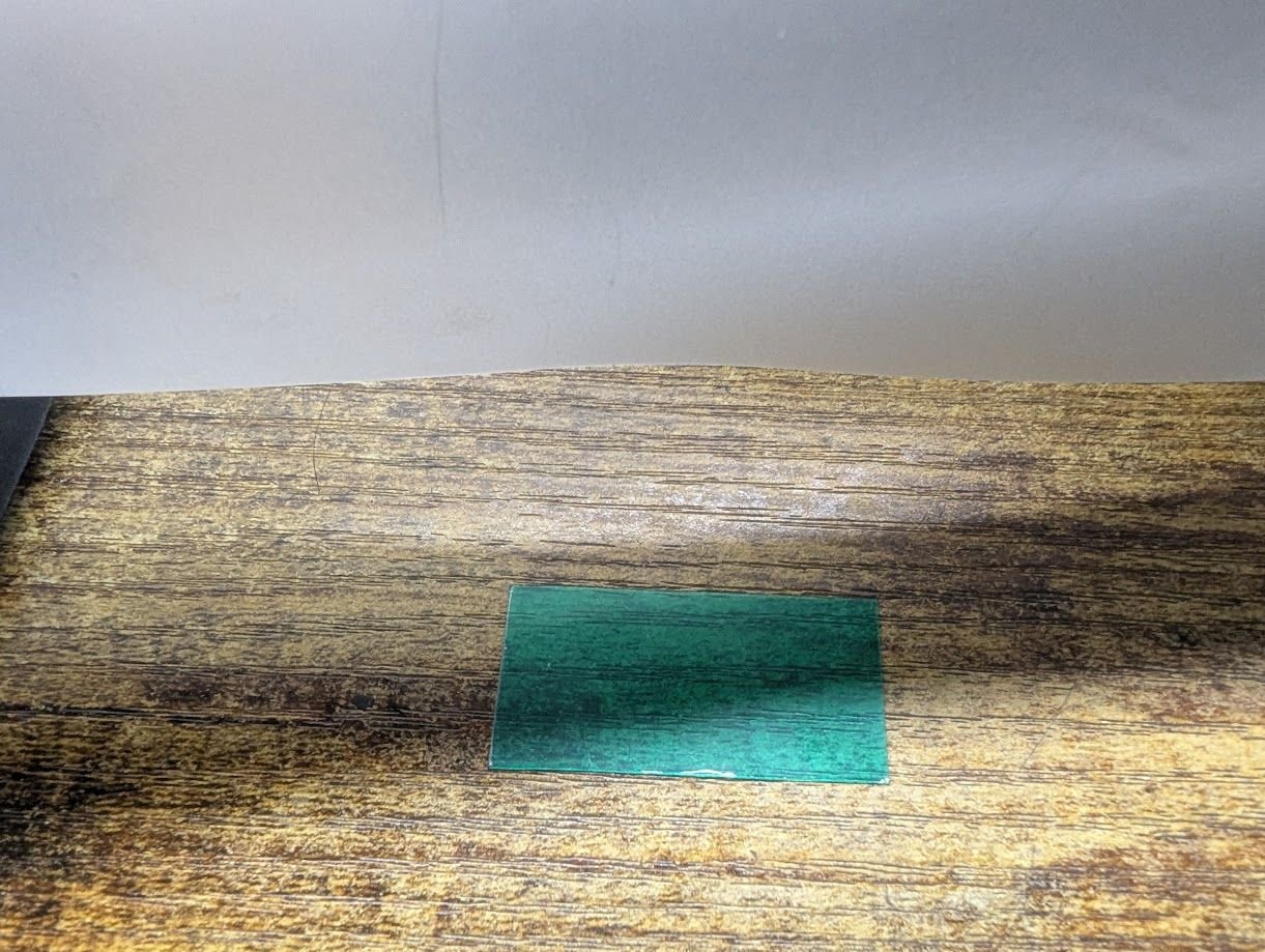

Since I wanted green, I got green gel sheet, the kind they use for stage and photo lighting. It's like $7 on Amazon. The gel is also transparent, and you will also see the bulb. What you need is a diffuser. There is also diffuser film that is also a photo/lighting thing. It is matte white. Both gels and diffuser come in fairly large sheets, which seems a bit wasteful, but there is no other way.
Using the original red diffuser as the template I cut two pieces of green gel and four pieces of matte diffuser. This gave me roughly the same opacity as the original. If you do this you may need to experiment with the exact composition of the filter. I taped the gels and diffusers together at the edges and reassembled.
