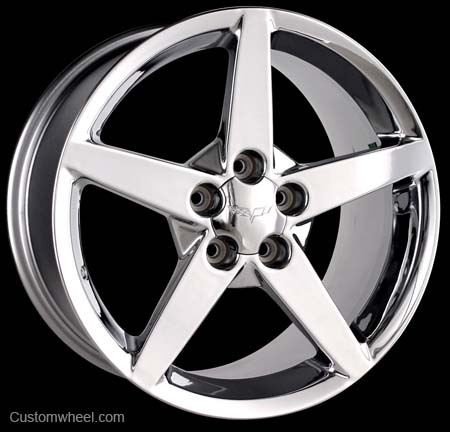

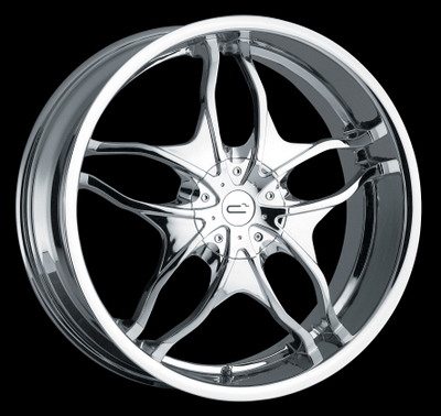

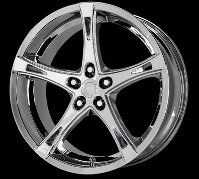

I have narrowed it down to these...
I think one of them is some sort of Corvette replica. I found them all on the Custom Wheel site. I think that all three would look good so I am kind of neutral.
I am going tire shopping first...
Attached Thumbnails Wheels, Tires and all that jazz...-verde.5ive.jpg   Wheels, Tires and all that jazz...-c3chromestandard.jpg   Wheels, Tires and all that jazz...-865-2005-c6-vette-replica-chrome.jpg

the last wheel you posted is a corvette replica. ive always been partial to a 5 spoke wheel...its classy and still looks cool. i like your choices!

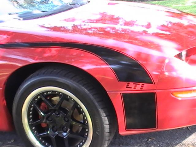

here's a shot of just the wheel

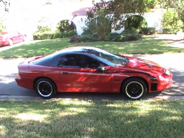

and here is how it sits on 17 x 9.5s with 275 40 17's

Mocha - I have those corvette wheels on my camaro and they are really nice. One other option you can do is go bigger rim in the back. Say 17 X 9.5's on the front with 275/40's, and then 18 X 10's on the back with maybe 300/30's. The 18's tires will be expensive, well expensive to me anyway. But it'll make the wheel well on the back look more filled in, but won't be much different than what you have now. One thing to keep in mind, if you go taller than what the factory 16's with 245/50's are, then you will throw off your speedo. The 17's with 175/40's are the same height as your stock 16's with 245/50's. To fix your speedo if you go taller, you'll need a power programmer to adjust your computer. Or the like programmer. Take a look at my pics for some of the covette wheels. My car has been lowered 2 inch's in the back and 1.5 in the front.
