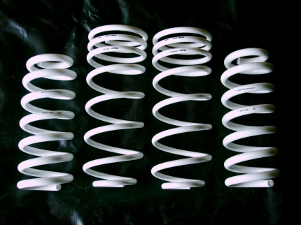

Strano lowering springs:
http://www.stranoparts.com/partdetai...=113&ModelID=7

if you want a 1/4 mile car don't lower it the stock springs r used in the rear of 8 second cars. so unless your springs r shot id stay stock and spend money on other suspension like LCAs. on proven thing that is weight and helps transfer weight at the line is removing the front sway bar. if you drive it i would just unhook it at the track
