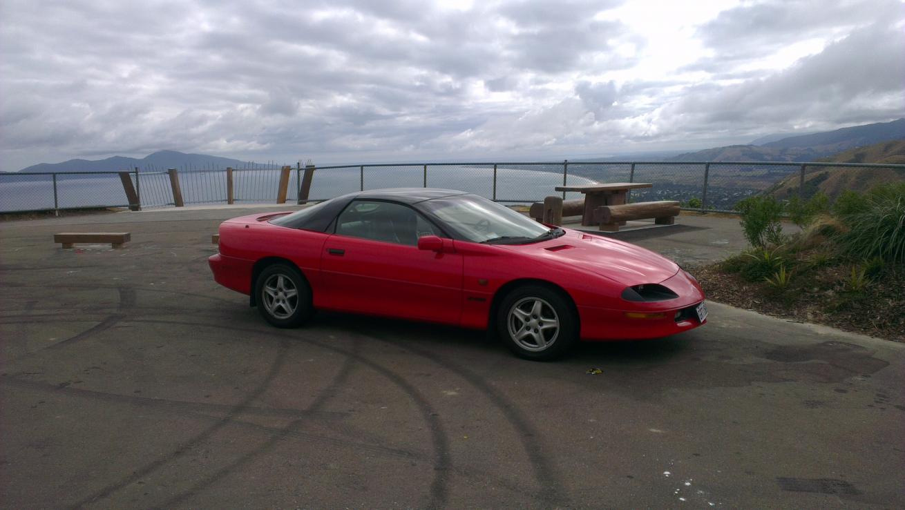

Heres a side view showing the wheels, they are factory wheels as far as I'm aware? - Can someone confirm

They look the same to me. Read the tires side wall. Should say PXXX/XX/RXX. The number after the R is the size of the wheels. Stock size for 4th gen Camaros was either 16 or 17 in. I highly doubt someone would have put different size wheels on the vehicle. Get a picture of the size wall of the tire if you can.

Weird. Even with it being an export, I do not see any reason why one set would be different, especially when they are the same style wheel.
Old Aug 15, 2014 | 07:32 AM
Those are 1997-up wheels. But regardless, 4th gen's (here at least) didn't come with 15" wheels.
Measure the diameter of the front wheels and see if they are the same as the back, they sure look the same in the pic.
Don't just go by what the tyre sidewall says. Someone could have made 15" tires fit by carving out the center of the tire. If that was done, do not drive the car till you replace the tires.
