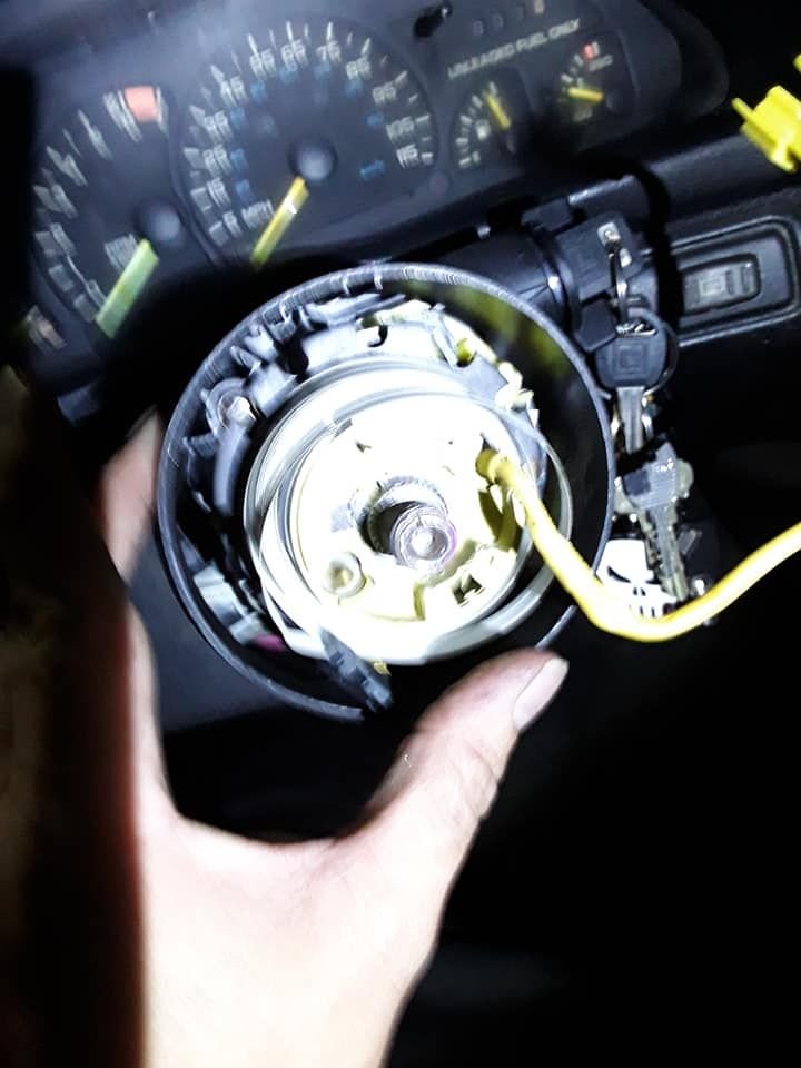

*Update: Thin Bracket Broke, what part is this? Wire Clip big problem yup.
Hi, my freelance mechanic looked at the car yesterday 1/22/20,
Aside from not being able to push down the wire clip or that circlular piece of metal that looks like a wedding ring, which somehow causes the horn to either be on continuously or what new problem I have now--a car horn not working. This wire clip has to be pushed in with a lot of force and with a picker pushed in so that it falls into 1 of many many grooves holding it in place.
The bracket that is sort of what holds the turn signal broke in 2 pieces, it is very thin and probably can't be welded together
On a '93 Camaro V-6, 3.4 Liter, my freelance mechanic said it's too thin to be welded together and probably I'd need to find another car like a F body Pontiac Firebird or maybe a Chevy Monte Carlo 1990s series like the 1 shown in the instructional vid at a junkyard and take that out from there only because this part probably might be Discontinued by GM? or..maybe the entire arm needs to be purchased a well over a $100 purchase?
So the 2 parts: 1) turn signal lever 2) turn signal switch did not need replacing-- actually the turn signals once the steering column was opened can be manually turned both on left arrow and right arrow inside the cabin and outside of the car.
I'd think this is called a turn signal bracket, it's like a metal piece with a hole and a screw and a bolt at the other end that holds the turn signal lever in place.
***This is such an Important Part, that It would make No sense for this part to be Discontinued by GM....I'm sure I am not the only one who applied to much force on the turn signal lever on a 4th Gen. Camaro, like maybe during a nervous tic or during a near motor vehicle accident (or an epileptic seizure) and the absence of this part will cause the turn signal never to work and cause "Fix It / Equipment Violations," /traffic tickets, for sure. I will have to take it to a repair shop with someone who has worked on hot rods and American sports cars in 1 week and he will hopefully order it directly from the GM / Chevy dealer...or order the entire arm body if this piece isn't sold separately.
So Gorn, or anyone else: know what this part is? or would I require its entire column / body of which this part belongs to?
In the pic, this part is found near the freelance mechanic's left index finger.
Here's a photo of the "broken turn signal bracket" anyone know what part this is? Part #_____
