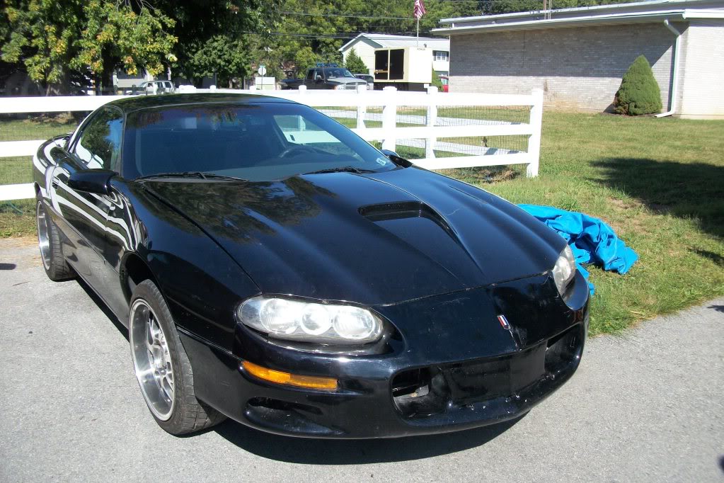

I do not have any photos of the swap but I have a car that has already but swapped. I can take pictures if needed.
My 93
