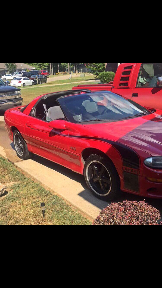

Should i Cam my v6 or do LS swap ??-photo669.jpgShould i Cam my v6 or do LS swap ??-photo944.jpgShould i Cam my v6 or do LS swap ??-photo945.jpgShould i Cam my v6 or do LS swap ??-photo69.jpg

looks great an like you got black zr1 wheels on there i would keep it just the way it is nice car , if you choose photo bucket open an account load your pictures there from your computer ,it was hard for me it took me a bit before it was explained,ok so open account photobucket is free,then when your ready to load it hear one picture at a time on the right side it will say share this photo an have 4 choises right click on the last one for this site it will say copied then left click an paste hear after that its pretty easy an then you know how to do it too, those are wheel covers on my 99,look like rims an my engine swap 406 an its on the bottle or can be i would not worry about wheels those look great unless you got to have chrome look
