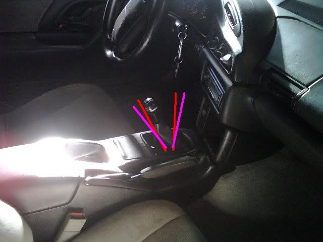

Just a FYI lets not confuse short throw shifters with short shifters. They are two different things. Most short throw shifter are near stock length. The short throw comes from where the pivot point is in relation to shift socket.
My T5 V6 has a Hurst short throw shifter, it is just as tall as the stock shifter. Because of the design I can easly hack off 2-1/2 inchs then it would be a short throw with short shifter handle.
Stock heigh short throw Hurst shifter, (Mad paint brush skillz!!)
