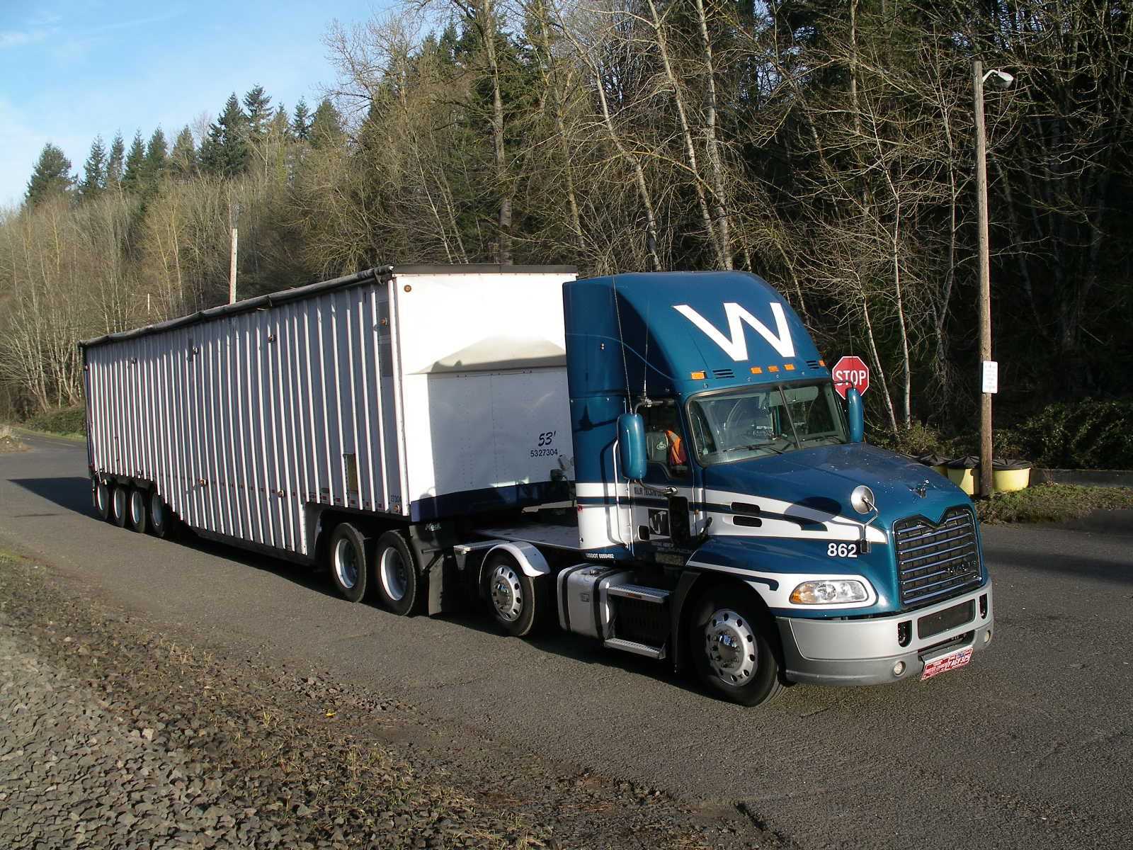

I ran that highway almost daily in one of these trucks for a few years,hauling wood chips from the Hampton lumber mill in Warrenton and to the paper mills at Wauna and Longview,Wa.
