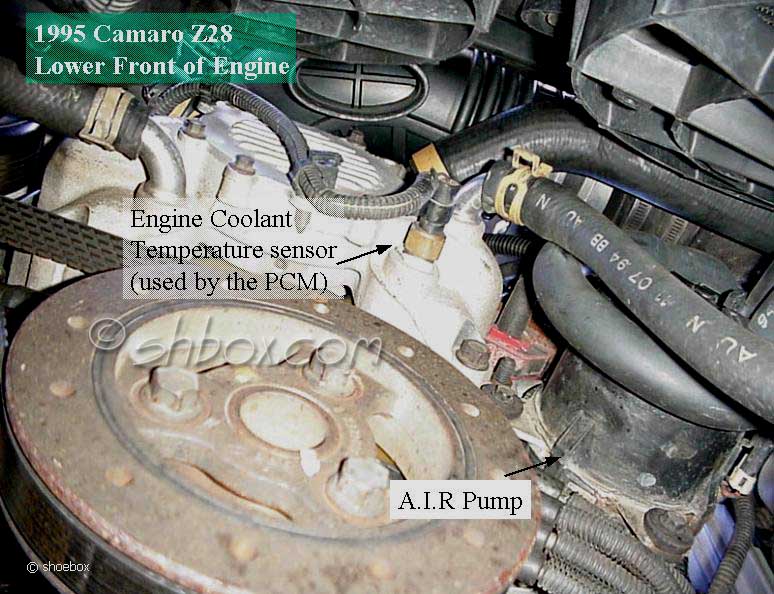

So i just put a new serp. belt on after the old one snapped on me yesterday and when i removed air filter assembly i noticed a red two prong plug just dangling there. I'm not sure if it goes to abs or brake system somewhere as it its near there, by the front of the driver side header.
Also i have the abs inop light on and i checked all fuses and noticed in the under hood fuse box the abs valve fuse has no power at all in or out. I'm wondering what could be the problem or that could be the abs problem.
Thanks for any help.. also here is a pic of the plug that i found unplugged.

looks like the emission pump plug.

Would you have a rough idea where it goes or a diagram. I couldn't find a spot for it or where it goes. and the wires are short so it can go far but not sure where...

it looks like your air pump is gone. should be right there. have you checked all the pluging places on the abs unit to make sure they all have something plugged into them.
