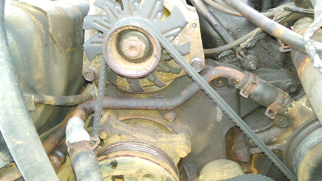

I have a '94 base 3.4L camaro that I am replacing the coolant hoses on. I need help identifying the metal hose that is right under the alternator. I have posted a picture of exactly the hose that needs to be replaced. I need to know the official name of this pipe so I can replace it and possibly where to order it from. Any help would be greatly appreciated!

looks like your heater hose or part of it, if you can find one an its not part of your AC lines ,you may need to run wear it is rubber on the right a rubber hose from there to the rad,you may find what you need under 94 3.4l heater hoses ebay,looks like there is a rubber replacement on ebay ,or you may need to make one ,finding certain parts for those cars can be hard ,so just make a hose an use rubber ,looks like it hooked righ to you water pump to the right ,dont think there would be a name try water pump hose or take it off an try junk yard ,but i would just run a hose with bend in it

Thank you so much!

called a heater outlet pipe in the 93 parts manual. part # 10151665
Old Mar 28, 2017 | 06:51 PM
Posts: 22,027
no longer available.

First of all I would like to thank, 95 Camaro 406, & craby for all your help! Just wanted to give a quick update. Instead of pulling at a junkyard or going to a metal fab shop, I just worked it out with hoses and connectors. Just an FYI, the heater hose is a 5/8 put lead up to a 3/4 sizing on the water pump. I was even able to run it under the radiator just like that stupid bypass pipe.
