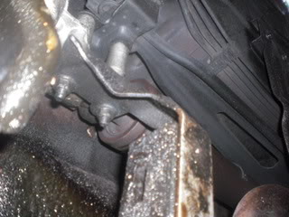

Can some on tell me what this thing hanging is it has the word AUTO i believe. I was thinking it is my trans mount but i dont see where it is suppose to hook up at. I drive a 94 z28 with the automatic trans. When i take off fast i think this is what i hear hitting the bottom of the car.

Old Jan 8, 2009 | 02:42 PM
Default RE: Please give me some help
Whoopsy-daisy! How did that get up there?
That long bar coming forward from the rearend it your torque arm.
And see that block that is hanging well below it, with the slot in it? That's where the end of the torque arm is supposed to be slipped into. Under torque, the nose (pinion) of the rearend wants to lift. The torque arm (when connected properly) prevents that from happening. Your arm also looks twisted, because it's supposed to be sitting vertically. What does it look like at the rearend, is it twisted or unbolted? And I would advise not driving the car like that, or the next thing you'll do is snap some u-joints off the driveshaft.

Old Jan 9, 2009 | 10:05 AM
That's an aftermarket torque arm and mount setup, so you won't find it on yours.
On your car, the front part of that long bar (torque arm) which is bolted to the rearend, is supposed to slip through that mounting block that you see hanging below the tail of the trans. Right now, your torque arm is pushed way up towards the tunnel/floor, which is also why you're hearing a "banging" noise. You need to pull the torque arm back down, and reattach it to the mount either by removing the mount, or the torque arm from the rearend. But it also looks like the arm is twisted. Take a picture of where the arm mounts to the rearend, as well as a rear to front shot, and post it here too. I'm curious what the rest looks like.

Old Jan 9, 2009 | 09:52 PM
That first set of pictures really makes it look like the arm is way high and out of place. But it looks normal in the last set of pics. I hate how camera angles can play tricks on you! [:@]
Now it looks like the end of the arm (at the trans) is in the bracket, is it? If it is, then don't worry about it. Now looking at that other block, it looks like the exhaust system hanger "receiver" where a hook bracket from the exhaust would slide through. Sorry if I worried you before, but from the other pics, it just didn't look right.
However, you are getting a banging noise? Check your trans mount, by pushing or lightly jacking up the tail,to see if it may have separated.
