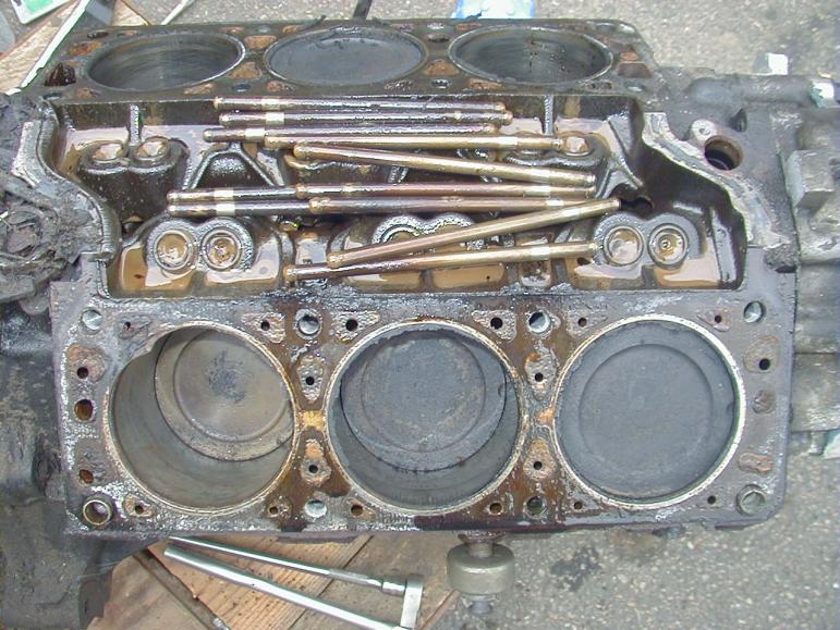

Blown head gasket:

What you get when coolant gets into the oil:
