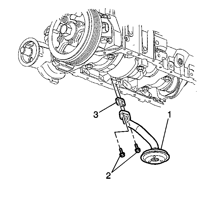

You also may want to look into the Oil Pump Suction Pipe and Screen Assembly where you would clean the screen and housing with solvent and blow dry with compressed air -- it could be clogged-up, this requires oil pan removal... See diagram below.
