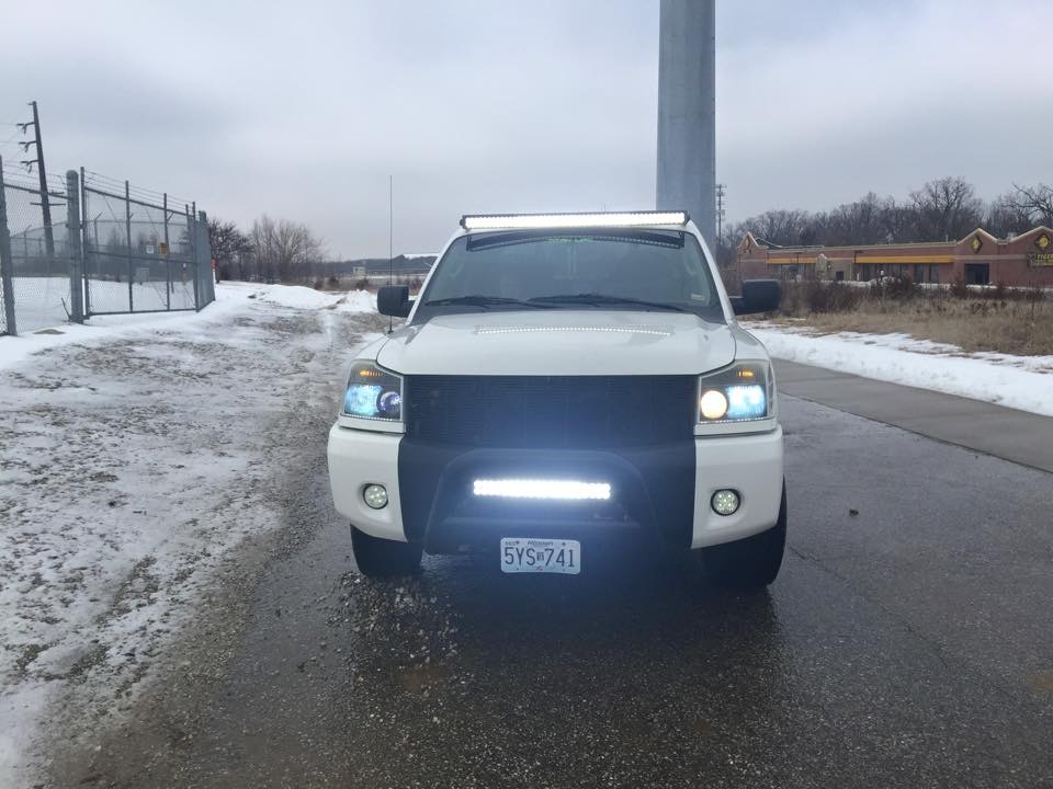

Well I'm not going to lie to anyone, I drive like a jackass. If I'm on the highway anything less then 80mph is unexceptionable. I accelerate hard, I brake hard, and I go around corners as fast as anything I own will let me and that's about 90% of the time. Another reason I put forth so much effort to try and make it right. I had an 08 Nissan Titan crew cab long bed 4x4. That was my baby. I put my heart in that truck and my wife took it from me. You live and you learn. Now I'm starting from the bottom. I am wondering, I have an SGS switch on my dash. Can anyone tell me what that is? It appears to be from the factor but I have never seen that type of switch before.
