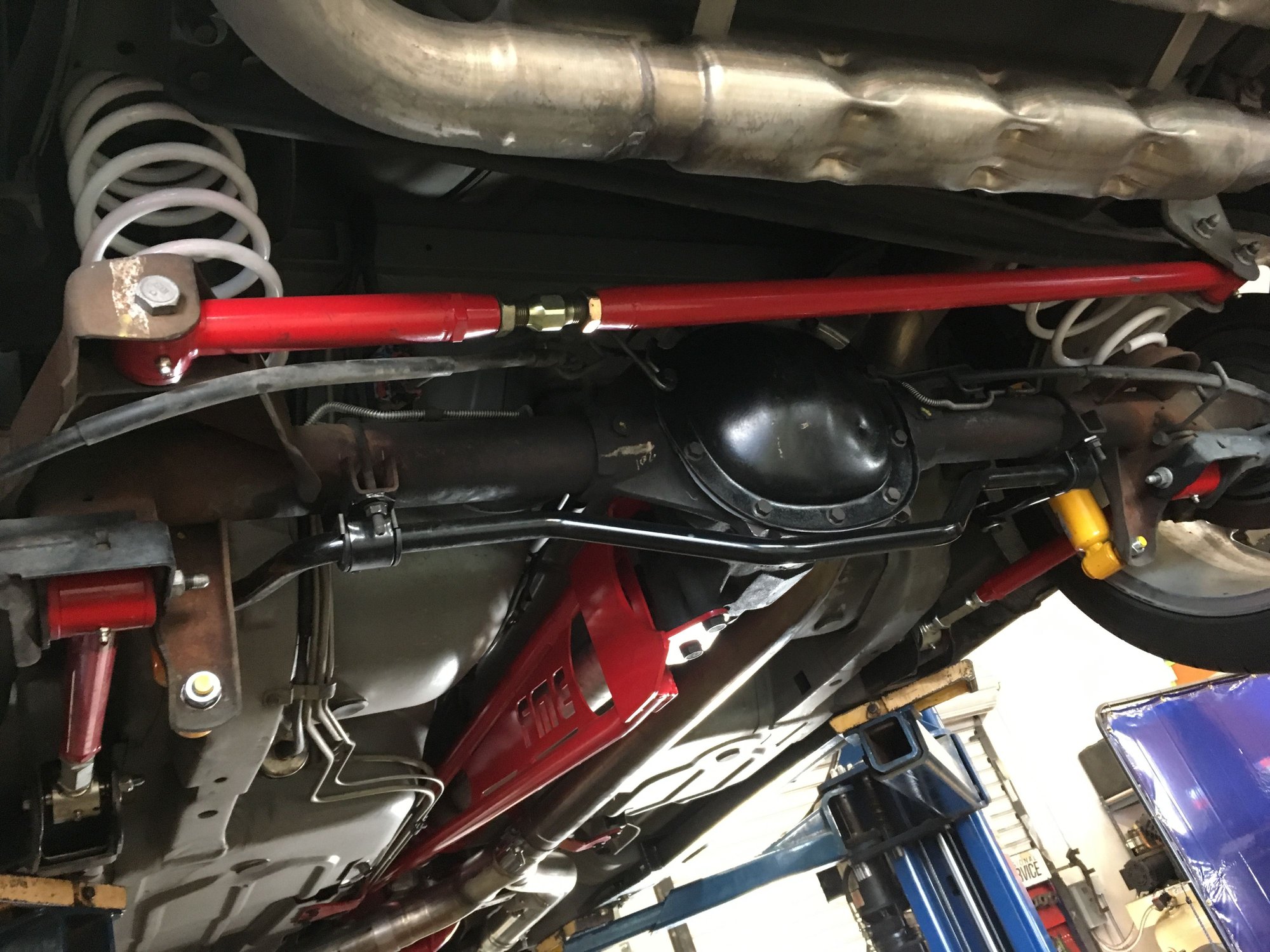

  • Spohn panhard bar
  • Spohn rear tubular control arms

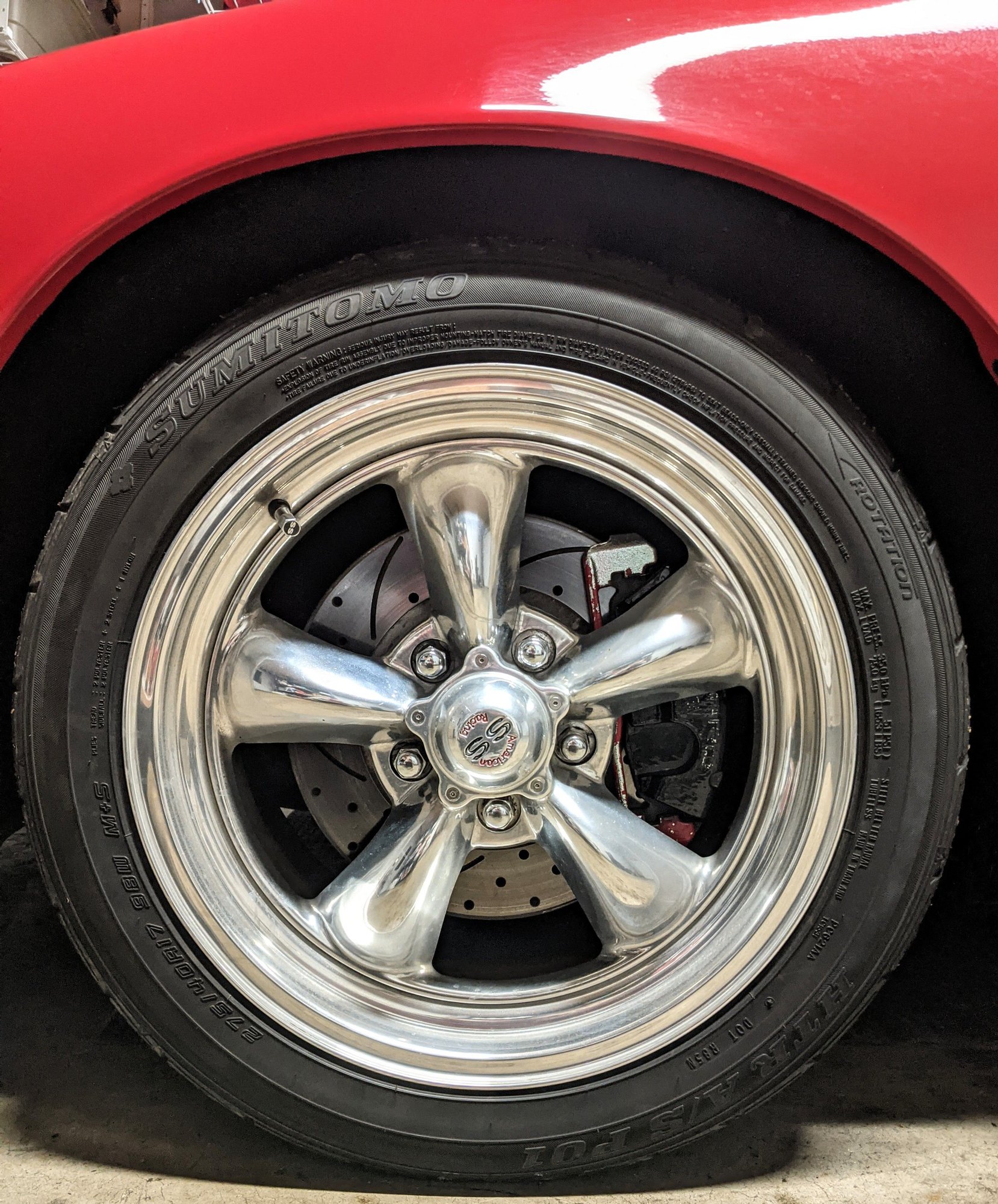

  • American racing Torq Thrust wheels W/ SS c caps

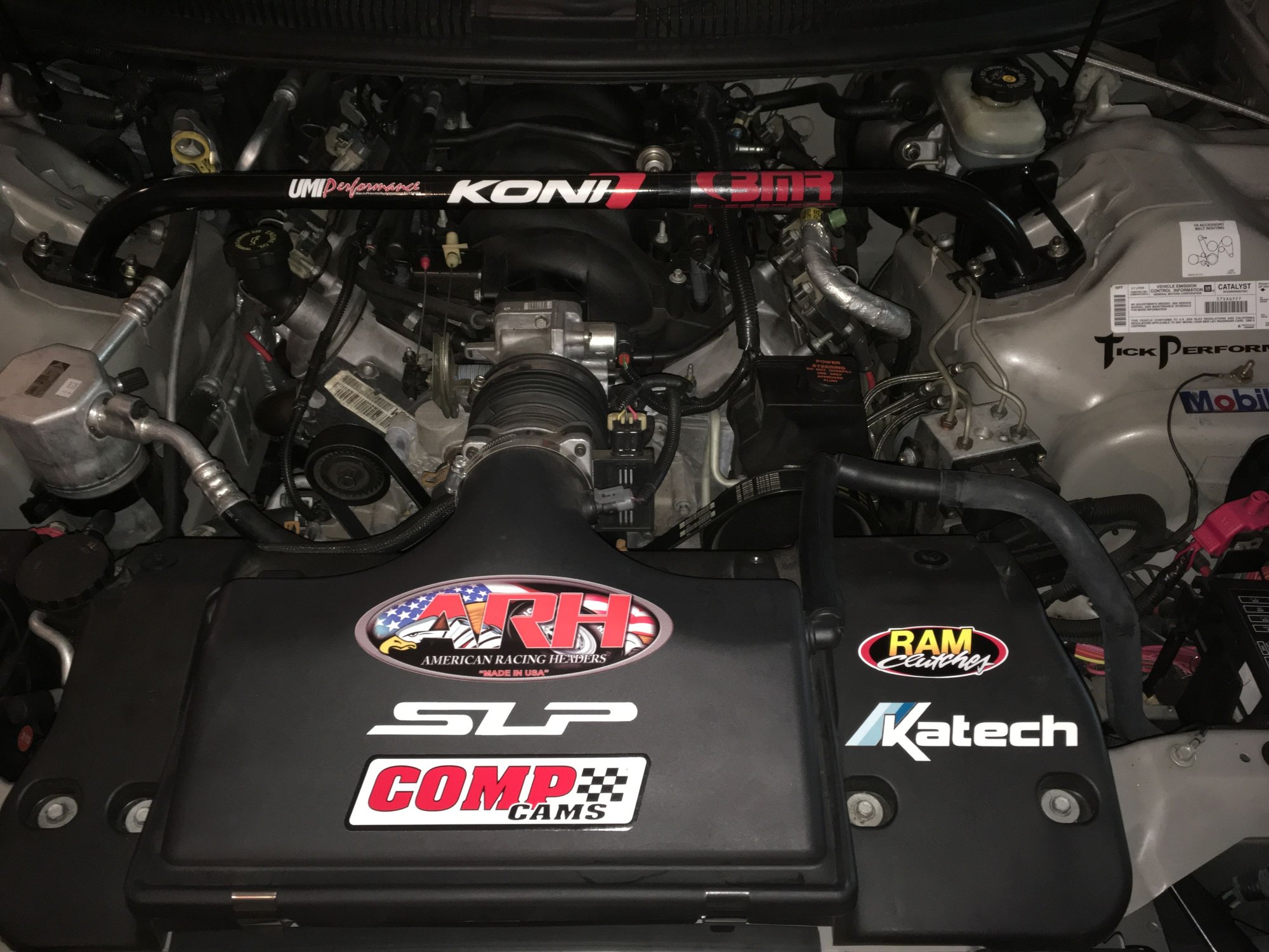

A couple inexpensive goodies that will help handling that go under the hood and are easy to install are a shock tower brace and a Strano brake master brace.

I also have Strano springs and sway bars in my car,much stronger than stock.

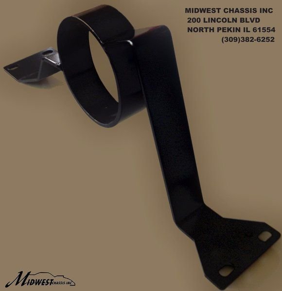

Adding a driveline loop is also a good idea if you're going to be banging gears.
I also added a set of BMR bolt on subframe connectors ,some say they don't do much but I like the idea of some added strength.

very happy with strano hollow tube sway bars. really made a difference. shock tower brace had a noticeable difference, did that before the sway bars.

Thanks everyone! I think sway bars and a strut brace would be a good start. I'm tackling fluids next weekend and fingers crossed for good weather on the 17th!
