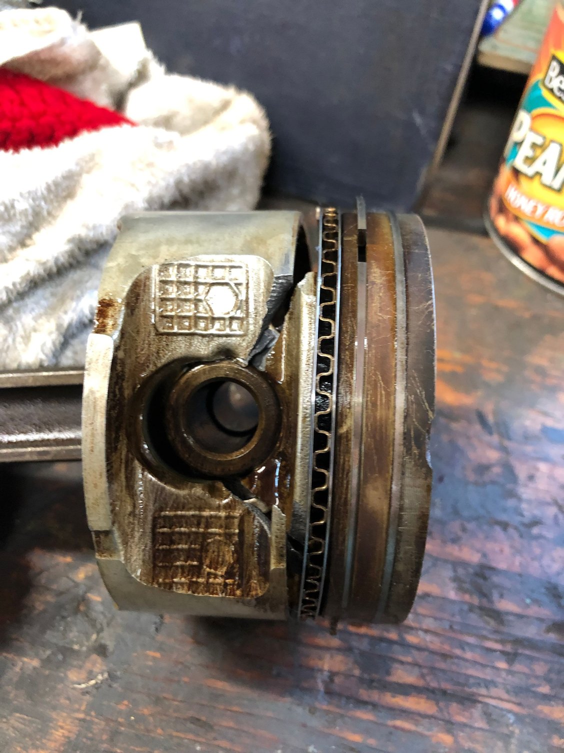

Hi everyone… so my daughter is about to turn 15 and someone gave her a 1995 Camaro 3.4 V6… it’s a deep purple so we named it Barney. Lol ! Anyways… I quickly found out why it was free… someone dropped a 2” T-bit on top of a piston and tried to start it. Long story short… the piston was cracked… like bad…. And I rebuilt the motor completely with new plugs and everything. After getting all the other stuff buttoned back up and all the wiring reattached… I was excited to cruise this nightmare for a test drive to get fresh fuel and test her out. Well… needless to say… that test drive didn’t happen. I brought in new fuel and tried a ton of things… but now I’m stumped. Her birthday is October 8th, and I would love to get this running for her.. especially after all my efforts and costs.

Old piston
