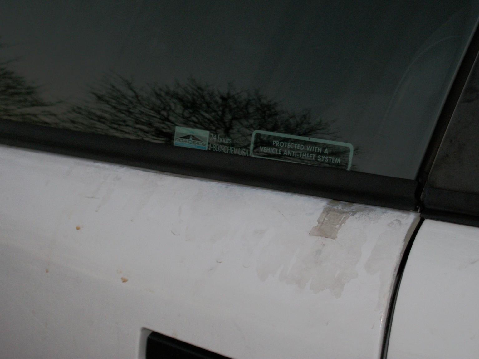

This piece on the window seems to not wanna stay down. I have took it out and pulled the hooks out a little, and put back in but it still will come up with the window. Anyone have any suggestions on how to fix this?
*Cant get images up but its the black trim the runs along the bottom of the window.
Here some images attached
Attached Thumbnails Need some trim help-100_0147.jpg   Need some trim help-100_0148.jpg

im gona say the lower lip has ripped. can u see if its coming apart? its called a sealing strip in the 93 book, should be the same part. gm part #10132209 do a search and see what comes up. i did a quick one and got a bunch of stuff but didnt find one. there are a few gm parts places on the net.

I searched the part number, but couldnt get a match and couldnt find it in my chiltons manual. I found this http://www.newgmparts.com/partlocato...layCatalogid=0 number 3 is it i think. But wow 55 dollars? I think i may try to just rig it somehow. Does that look like its it?

that does look like the part. they call it a belt strip. wow is right.

I think im going to take of the inside panel today and see if i can get to it or get a better view of it, but I'm guessin ima have to bite the bullet on this one.

if u roll the window all the way down it should let u see in there better too. have u tried cleaning it with soap an water. could have something sticky on it so it grabs the window on the way up.
