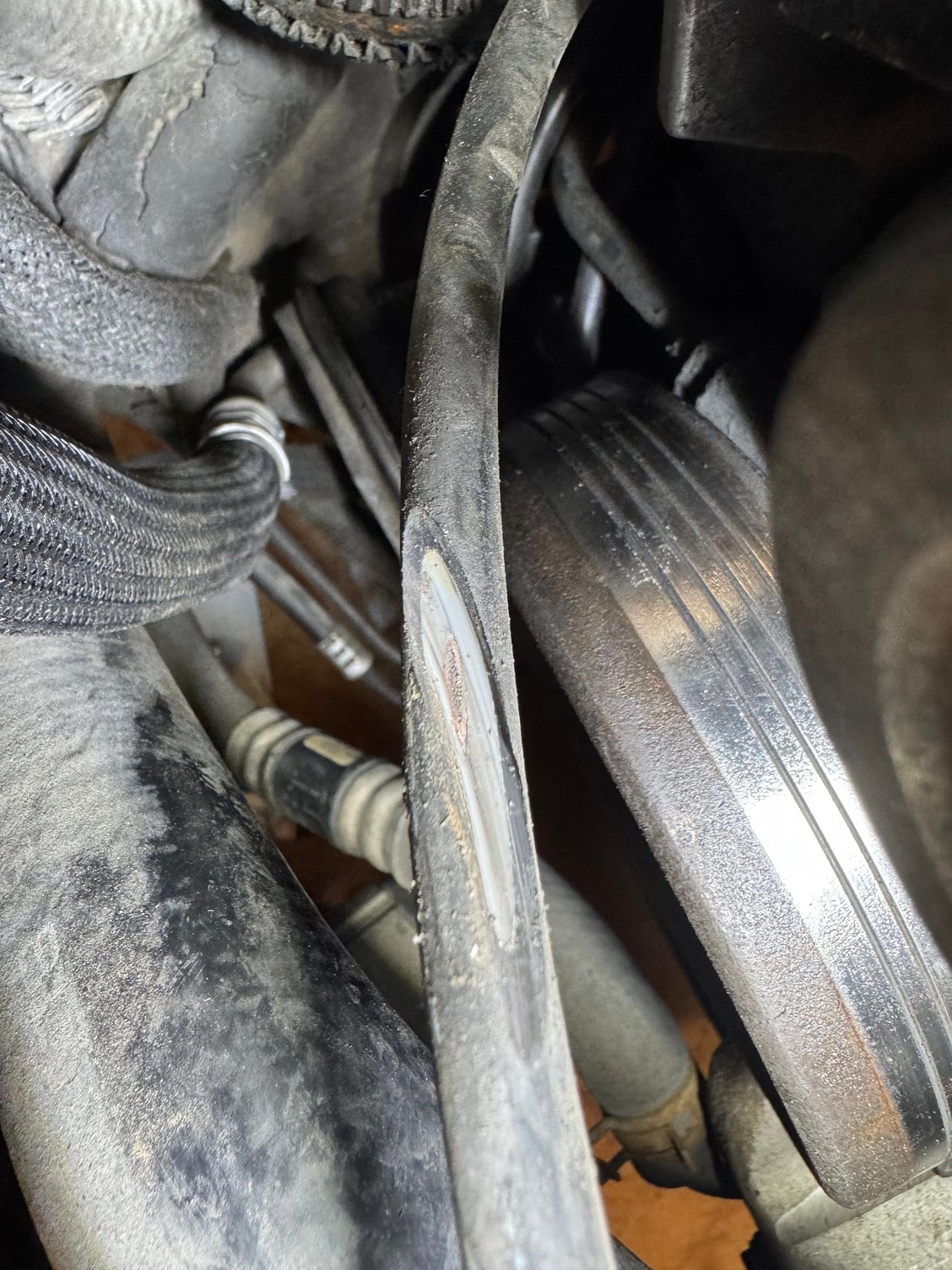

I figured the first thing I would do would be an oil change and tune up. Several plug wires were rubbing on the PS pulley and cut down to the wire. That is an easy fix. While I was there I replaced the belt and tensioner.
Even with new plugs and wires it still idles like crap.

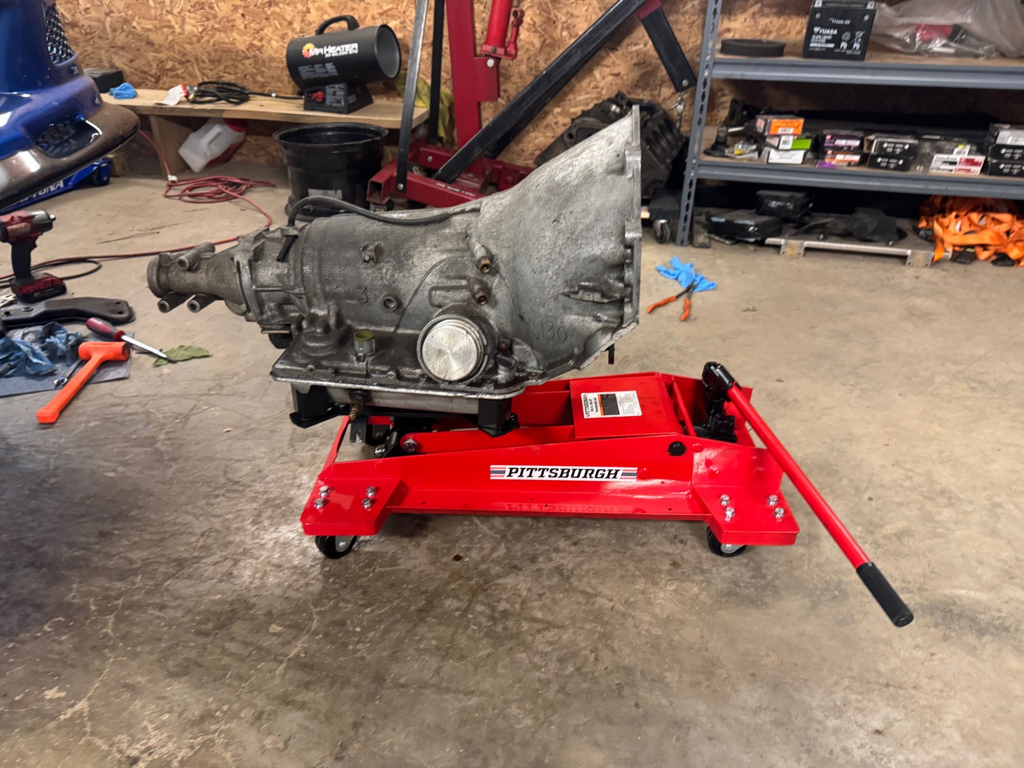

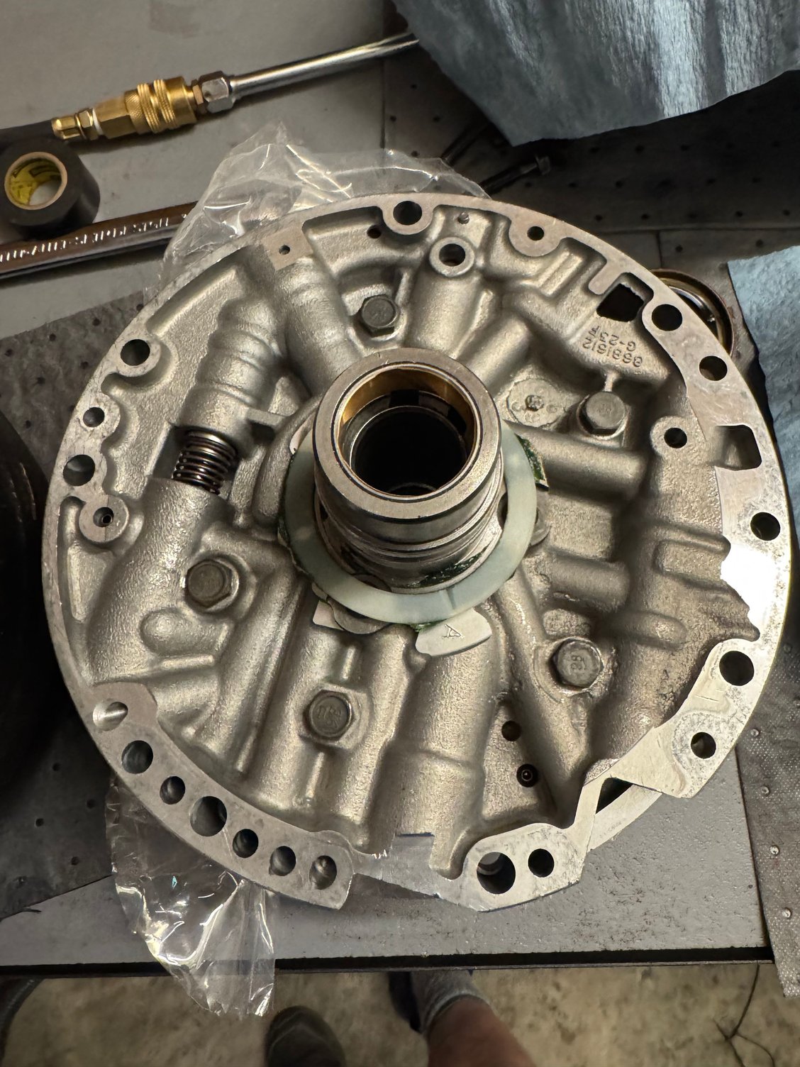

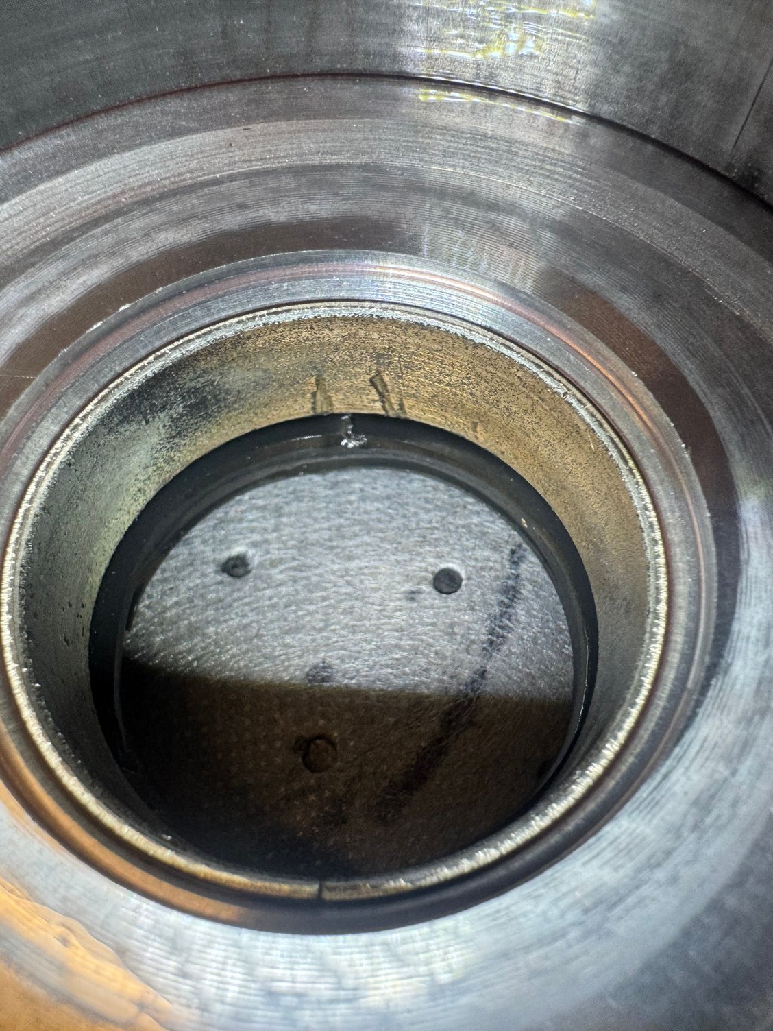

Had a large leak from the front bushing on my transmission pump. It would leak with moderate driving. If you floored it the front seal would spray ATF.
Pulled the transmission and what do you know. The front pump bushing is wiped out. The converter depth was shallow into the pump.
With a new pump the transmission was installed back in.

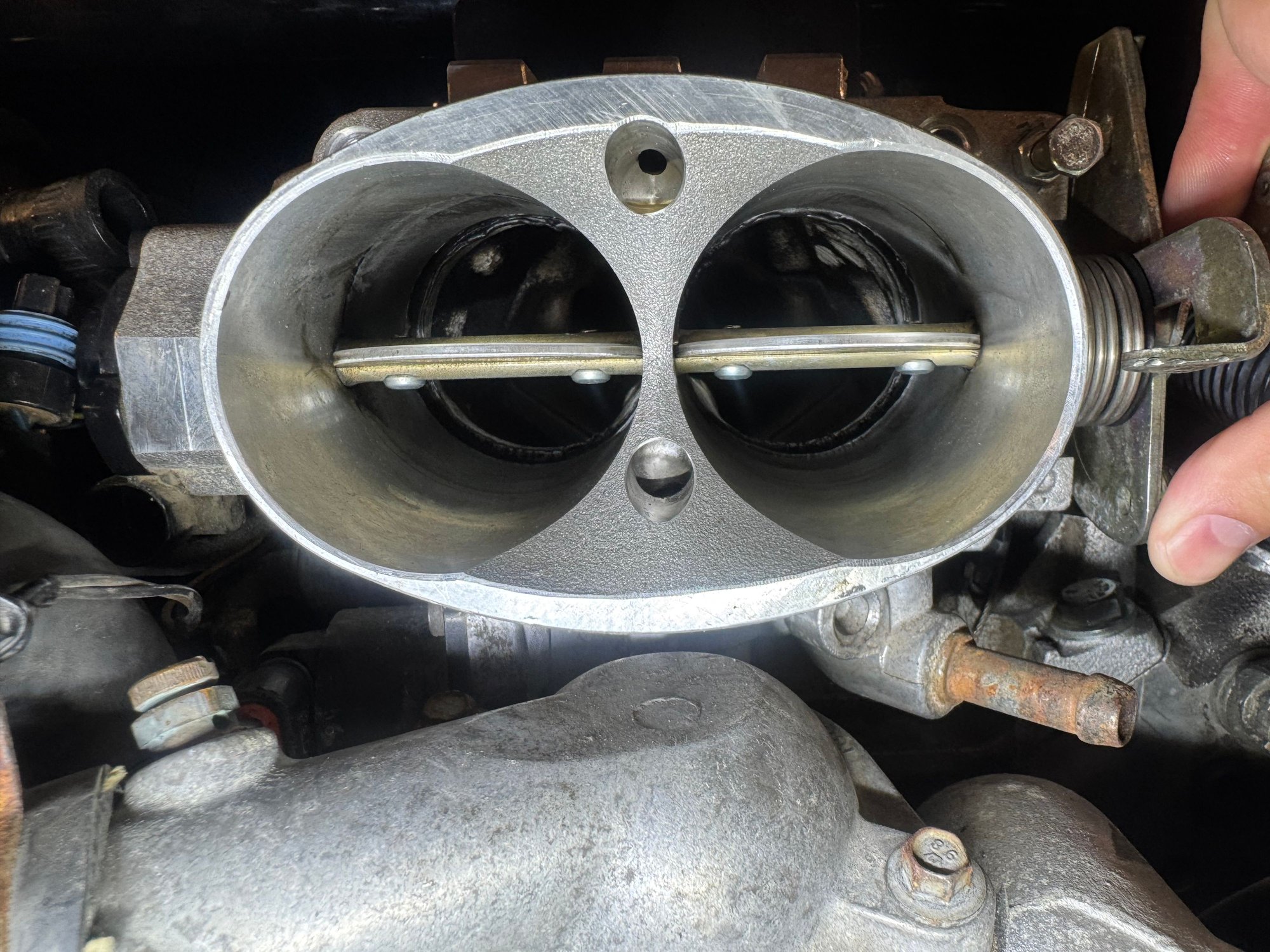

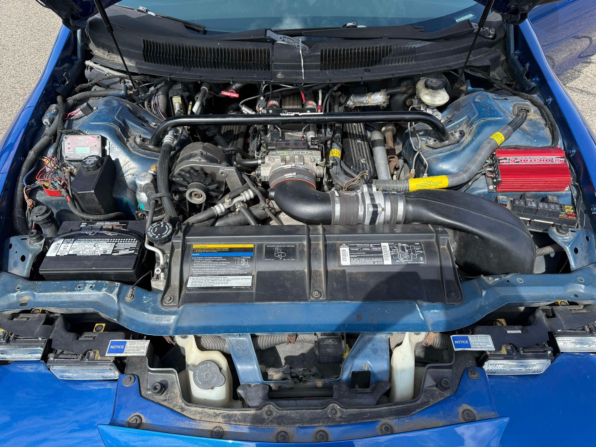

The next thing was fixing the surging idle. While doing a datalog I noticed my IAC was pegged at 160 and BLM split was off. That is a pretty big clue.
I have an aftermarket 58mm throttle body. Not sure what brand it is. It looks like a BBK but doesn’t have the markings. I see the throttle body doesn’t have a bypass port like the stock throttle body. Drilled a 1/8” port like the stock one has.
After reinstalling my throttle body it now idles great. BLM splits are almost perfect. My IAC count while not perfect is about 50 at idle. I could probably go 1/16” bigger on the port but probably won’t mess with it.
