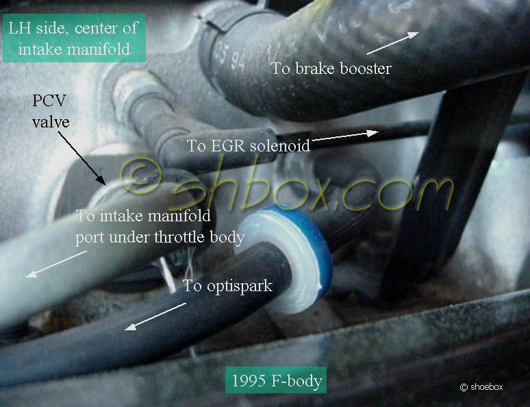

picture would help a great deal. could be hvac hose. http://shbox.com/1/vac_check_valve.jpg

pcv valve is on the driver side. lol, ok when i seen right side i skipped the from the front. you have a vacuum to vent for the opti, the egr vacuum and the brake boost hose.
Attached Thumbnails Hose popped off while driving, car now sounds like a helicoptor-opti_vacuum_conn.jpg

That's nowhere near the intake manifold as shown ^

There are a few vacuum lines in that area. I am guessing that it is the opti spark vent/vacuum line since it is routed in that direction and I think the only soft line in the area. Most of the other lines are hard lines (the vacuum line for the solenoid for the AIR pump). EGR heads towards the back of the motor to the EGR valve and a brake booster line you would absolutely know was missing (you would have to stand on the brakes to stop and the car may not idle at all)!
I have attached a few pictures of mine if you want to point out the area and we can try to help better narrow it down.
