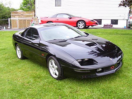

Thanks! Is that your 94 with an SS hood on it?
