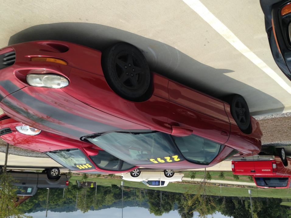

here is an outside shot of the 98 car they think has a blown head gasket not really my taste but its a 5 speed and about the best and opnly 5 speed I can find right now remember its 1500 out the door

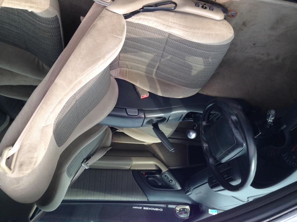

another of the interior sorry they are upside down but they are not like that on my end so don't know why they are like that. dash is still in one piece not cracked or anything. I mean 1,500 out the door that's fees and all im thinking worst case I still might have to put a motor in it if there head gasket fix don't last I don't think it would be to bad of a gamble just want to know what others think thanks..
