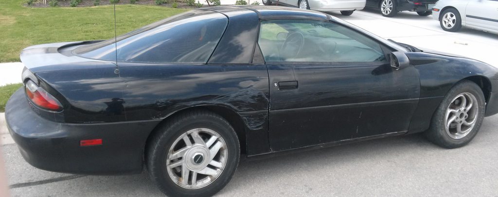

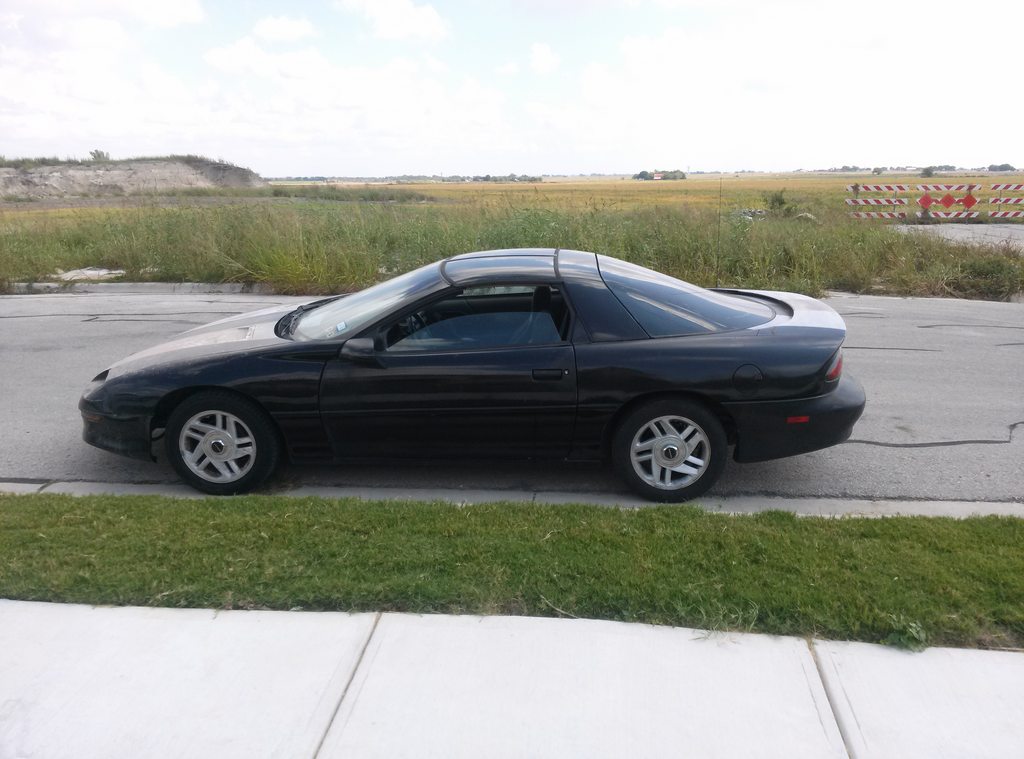

Figured I'd make a post and introduce myself. I've been an F-body fan in general since I was young, and got my first Camaro at 16 years old - a 1984 Berlinetta with a V6 (and a pretty sad one, at that!). I graduated up to a 1988 SC with a throttle-body injected 305 and an automatic transmission the following year, and spent most of my free time (and money!) on it until I went to college, when I was lucky enough to receive a 98 V6/auto car from my father. At some point I sold the 88 when I didn't have anywhere to store it any longer, and continued to drive the 98 for several more years (and across country when I moved!), until it finally dropped a valve at somewhere near 250k fairly hard miles. I didn't have the funds to repair it, or a place to store it, at the time, so it was sold to the highest bidder at a sad price, and I moved onto the cheapest econobox I could find just to get me around.
Fast forward to yesterday, and I tripped on an ad on Craigslist for a "1994 Camaro Z28" with very little info and a crappy picture, but the price was excellent and the seller was throwing in a handful of parts he had laying around his shop, as well, so I went to go check it out.
After my first look and hearing it run, I was still on the fence, even with its low price, and I worked it out with the seller to let me sleep on it, as he had given me a bit of an odd story. He told me that the man he purchased the car from, had had 2 camaros - the Z28 I was looking at, and a V6 of the same year. Somehow, the Z28 got totalled, and its parts put into the V6 chassis - rear end and all. Of course I was a bit curious, so I ran the VIN through a decoder and sure enough, it came back as a 1995 V6/5-speed car, but having seen the LT1 under the hood, and pulled the car through all 6 gears and reverse, it seemed like the weird story may be true, and I wasn't quite sure what to do at that point.
Of course, since its been so long since I've had a Camaro, most of that didn't end up mattering in the long run, and when I went back this morning and started it up again, I knew I had to bring it home.
So we finalized the deal, and despite her problems and a bit of wear and tear, I brought home what seems to be a fairly respectable project 95 Z28 clone, with an LT1 and M6.
Sorry for the poor quality pictures, I'll see if I can get any better tomorrow. She's definitely not the prettiest on the block, nor do I expect her to ever be the fastest, but even with her problems (like a failing head gasket! :O ), it still put a MASSIVE grin on my face on the short drive home, and I was instantly hooked again.
So anyway, hi!
Glad to be back on the right team, and I can't wait to get back to wrenching, its been way too long!

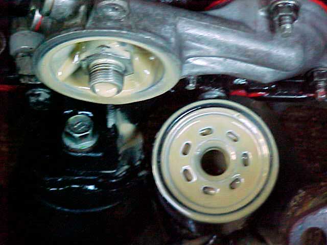

FYI when you mix oil with coolant and you run the engine she is done for. When you pressurize the coolant/oil mixture it causes a chemical reaction that releases an acid. That acid will melt away the babbitt on the bearing. It will also deposit said babbitt into you oil passages so it can ruin your new bearing after you install them.
Back when I worked at the dealer we always fixed warranty work. If a car needed a crank and 5 connecting rods then that was what it got. The only exception to that was coolant in the oil. Coolant in the oil and ANY noise GM just sent in a new motor. The cost of fix a coolant contaminated engine was not worth it. You must strip it down to the bare cast block and dip it in a strong acid and flush it. Now you are ready to start your rebuild.
You are better off finding a used motor. It is a lot of work doing those head gaskets. Last thing you want is 4 weeks later to be replacing the motor.
