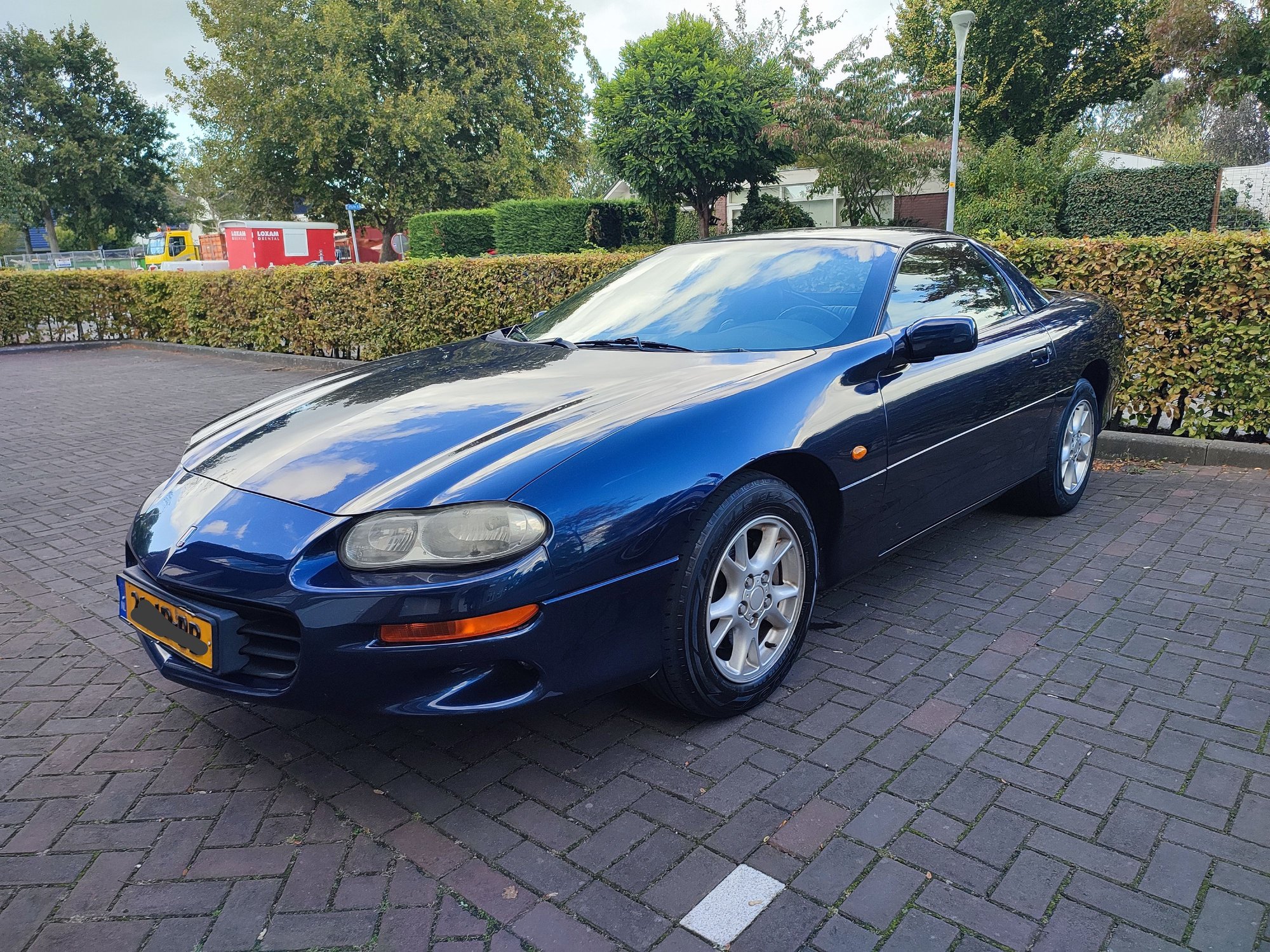

Hi there, new guy with my first 4th gen Camaro.
I bought it a week ago with 125k miles. In general in a much better shape than my SN95.

Other than the above issues I am very happy with it...
