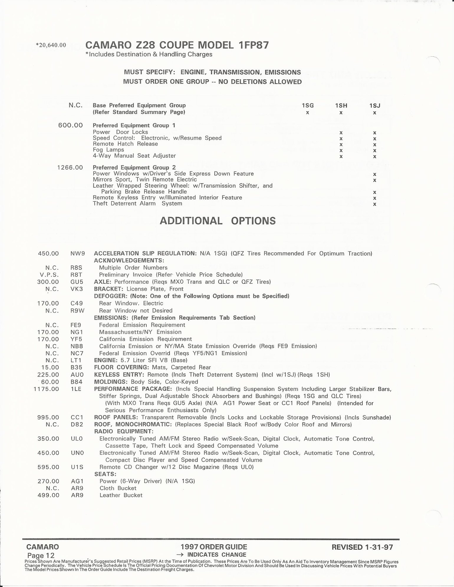

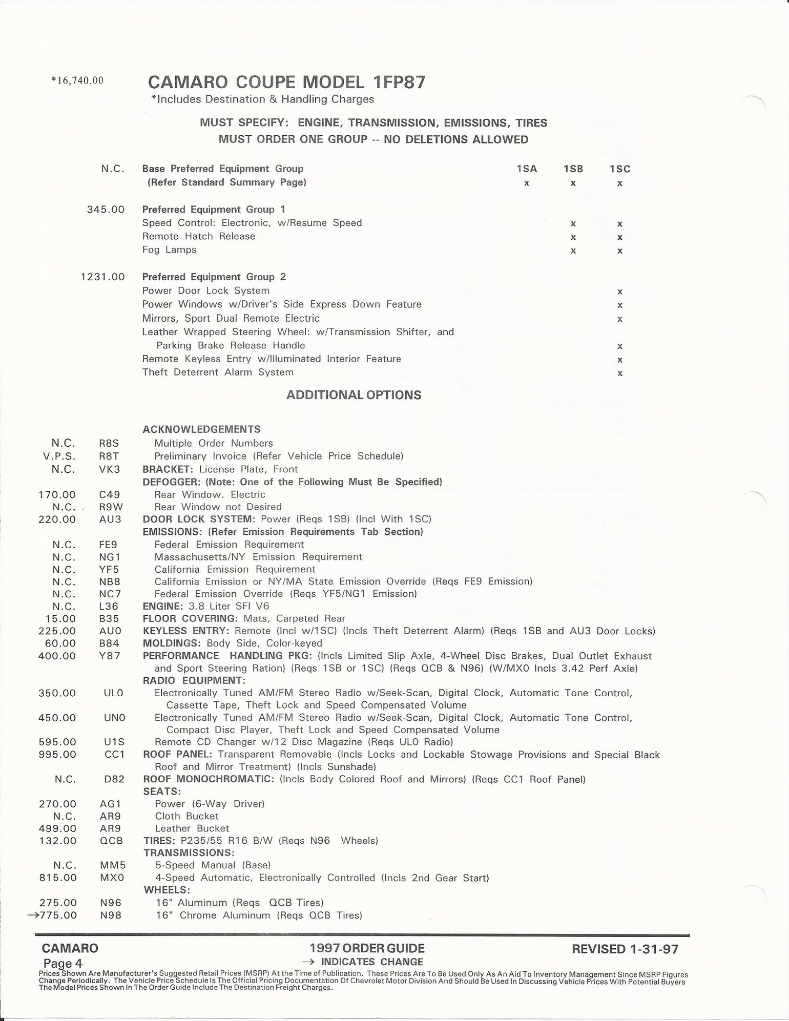

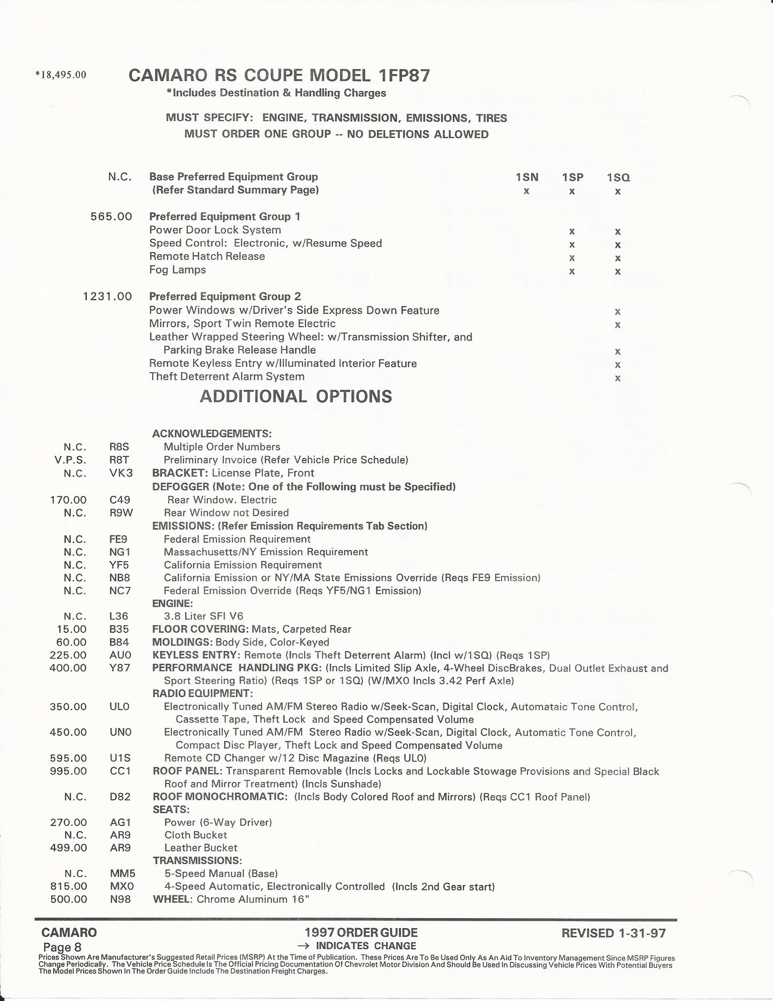

A base model Camaro Coupe (RPO 1SA), a base model RS Coupe (RPO 1SN) or a base model Z28 (RPO 1SG) was not offered with the fog lights according to the 1997 Chevrolet Order Guide. The car would have to had been ordered with a Preferred Equipment Group 1 or 2 to get them. Check your Service Parts Identification label to see what RPO's your car came from the factory with. If it had one of the Preferred Equipment Groups RPOs shown in the pictures below, it would have definitely had the fog light connector. It could be possible that a base model car may not have any components of the fog light system.
