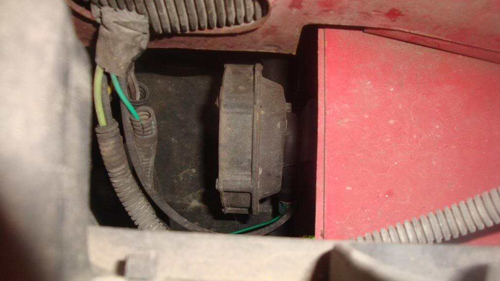

I think these are the horns. Never really looked for them but this is right below passenger headlights.

Old May 20, 2013 | 10:30 AM
^ Yeah that's the horn. Between the two, pulling the fuse will be the easier way.
