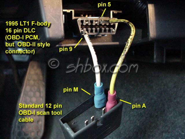

I didn't see any wiring for a MAF sensor. I tried to get it scanned but noone I found has a OBD1 scanner. I may have to go to the dealer. I'll look on the computer if theres anything. Where are they located on these cars?
Old Jan 10, 2018 | 03:59 PM
Posts: 22,027
they are under the hood on the rear side of passenger side fender well. 95 has a obd computer with a obd2 plugin. brb

if you havent yet, go here and download the factory service/shop manual for your year. https://www.mediafire.com/?40mfgeoe4ctti
