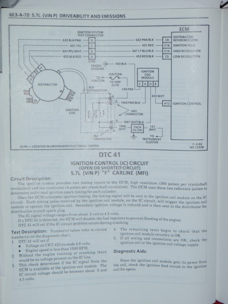

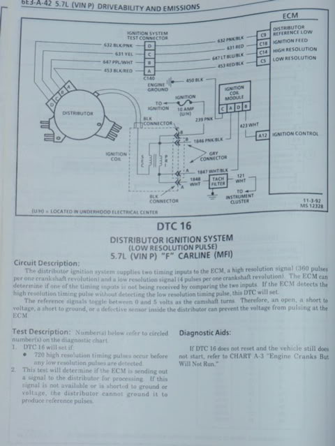

wow,,, and it runs, jk lets see theres a list in the info sticky. brb ok its not in the sticky, its on shbox here http://shbox.com/1/Dtcs.htm
Old Apr 9, 2013 | 04:41 PM
For obvious reasons, I would start with fixing this one first....code 51: EPROM programming error-faulty or incorrect PROM.
Old Apr 9, 2013 | 04:53 PM
Posts: 22,042

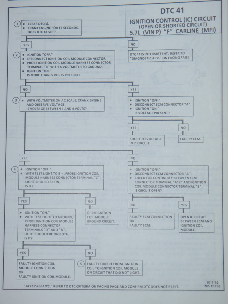

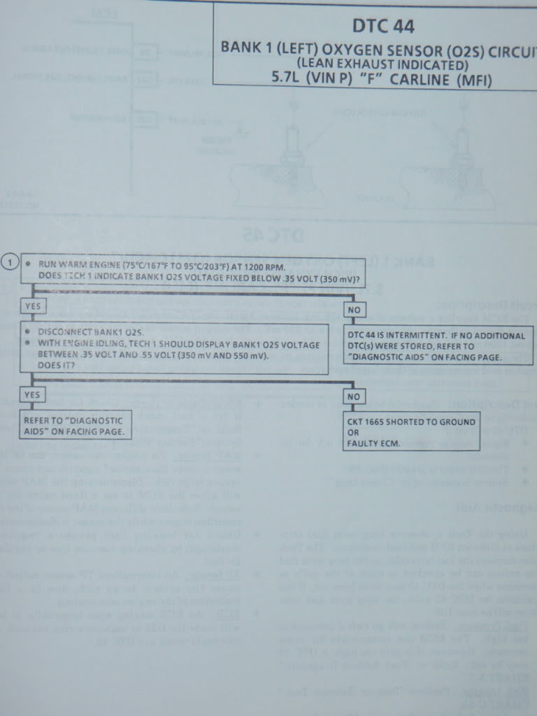

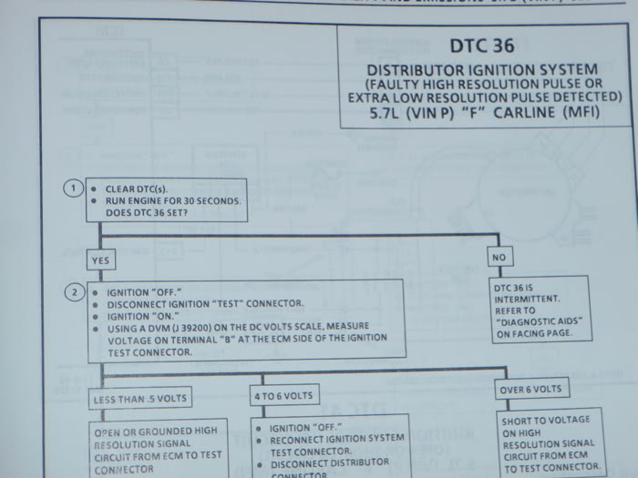

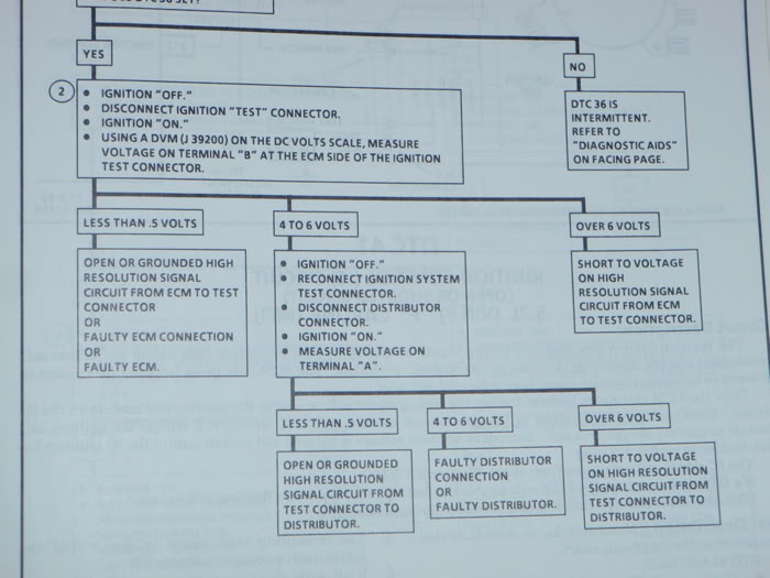

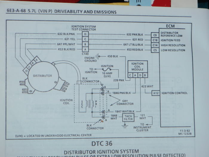

agree ^^^ deal with 51 and reset. heres a few i have info already
