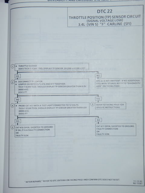

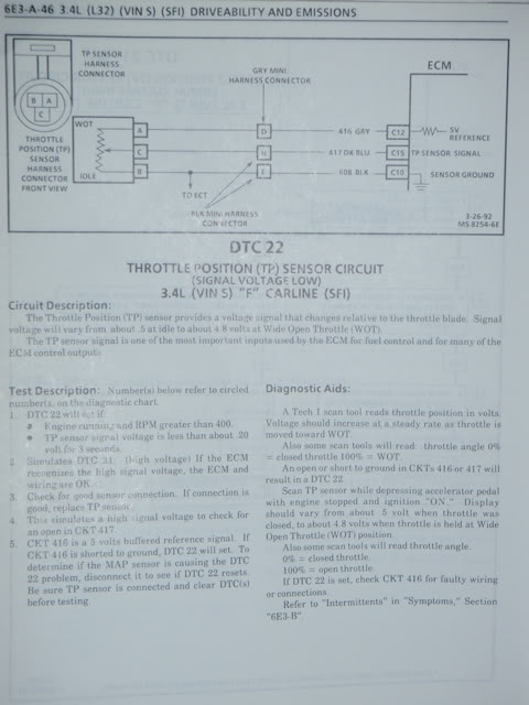

Code.22 pops up saying low circuit does anyone have any clue on how to fix this problem???

Assuming this is an OBD I car, it is a throttle position sensor voltage low.

Yes this is a lt1 96 what would be the way to fix this problem?

same as v8, the plug is sideways instead of up down. ohm meter should show like .5 volts at idle and 5 volts or close to it at wot.
