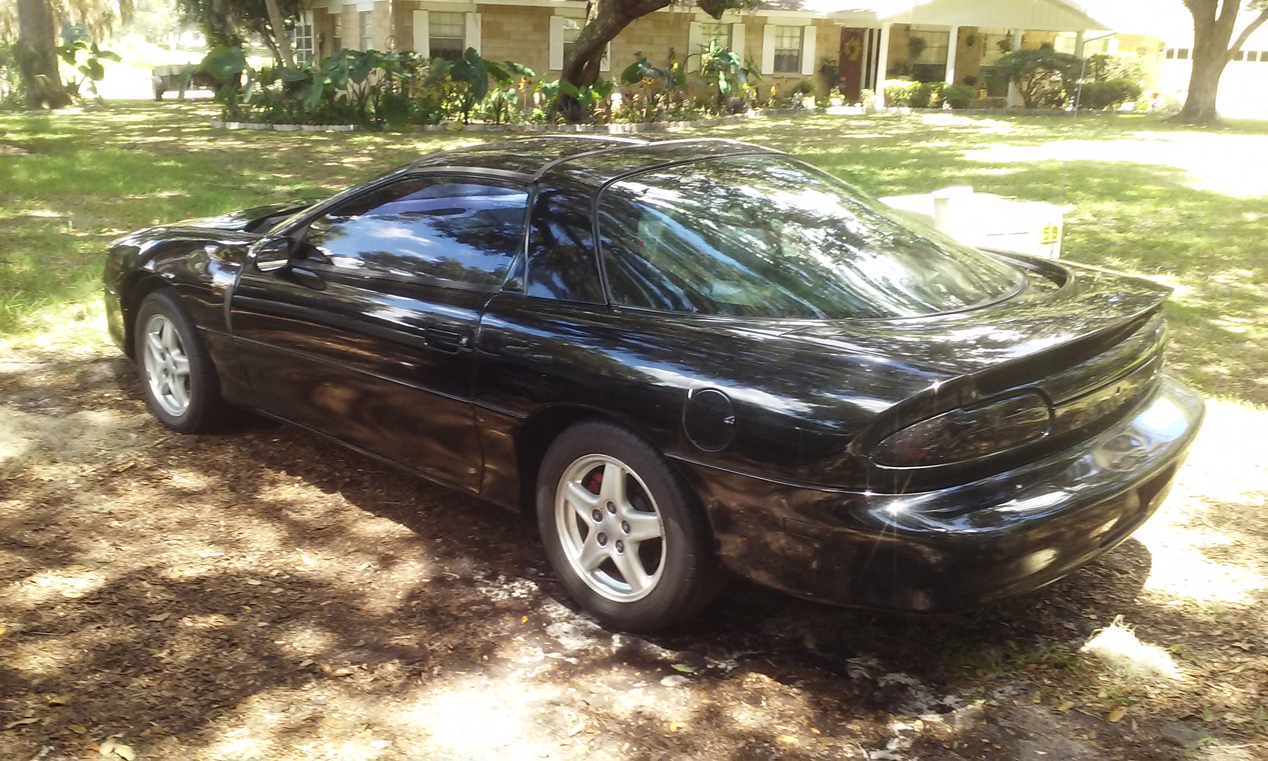

So I pulled the trigger guys. if she turns out to be a bust.. so be it! ill have learned something and thats priceless to me. every used car is a gamble and especially so for one listed as a mechanic special(moreso for someone who aint a mechanic lol). i know alot more about these cars than i did when i bought my 93(kind of lucked out there as that one was in really good shape despite the fuel mileage issues im sure some of you are aware im having) but i still have alot to learn. she does need ALOT of work but I kind of wanted something like that. Ok so heres the situation..
The important info:
-Body and engine have 120k on them. the engine runs good and sounds awesome. he had it on a battery charger when i pulled up with the hood open and i immediately felt the engine to see if it had been fired up and it was cold though he fired it up basically right away after we did introductions and greetings and pleasantries. it fired right up without any hesitation and idled smooth. it was a little loud because a portion of the muffler was disconnected but it sounded.. healthy i guess is how i would describe it. that said i have zero experience with ls1 engines and this was really my first chance to see one in person instead of pictures online. i had watched a few videos of engine noises in these cars as well as videos of healthy running ls1's.. now i know that doesnt really qualify me to state definitively that it is healthy but thats just my unprofessional impression.
-no strange noises at all.. no ticks, knocks, slaps, nothing aside from a very slight and minor ping from the flex plate(due to the trans being removed). he noted this in the ad and i even had to get on my knees with my ear under the car to even hear it. hell it sounded better than my lt1.. also worth noting it was 95-100+ degree florida heat and boy after an hour of inspection i was about to have heat exhaustion lol..

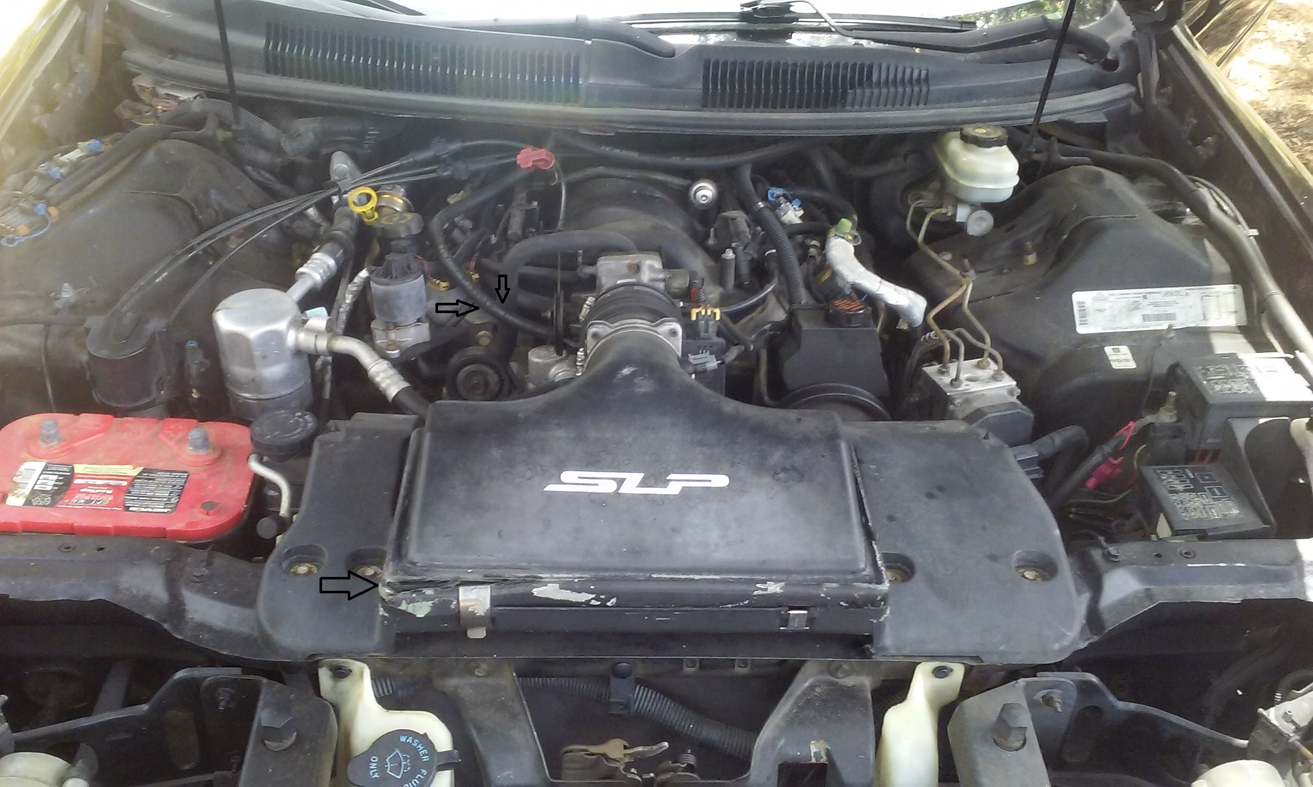

-the air filter housing was slightly damaged on the pass side corner and there is a hose disconnected that didnt seem to have any immediate place to plug it back in. in the picture the 3 arrows point to that disconnected hose and the damage to the air filter housing.
-the underside of the car was pretty dirty aside from the differential which had not a single bit of dirt on it. when i said "wow that differential is spotless!" he said that apparently the rear end was replaced but the guy couldnt give me any more information than that. he did live on a sandy dirt road with no cement driveway fwiw. he did say that in the process of removing the transmission he got tranny fluid all over the place. i suppose that would account for some of the grime however i honestly wouldnt really know any better.
-the bottom of the engine had the normal grime but there didnt appear to be any fresh fluid leak but that also could be from sitting for 3 months and only being run occasionally.
-after towing it home with the engine running for the 3 hours or so during the return trip(so we had power steering and power brakes).. temps were consistent as was the oil pressure. power steering works but i suspect a possible leak as the fluid level was low. i checked it again after arriving at home and it was at the same level so its a small leak if at all.

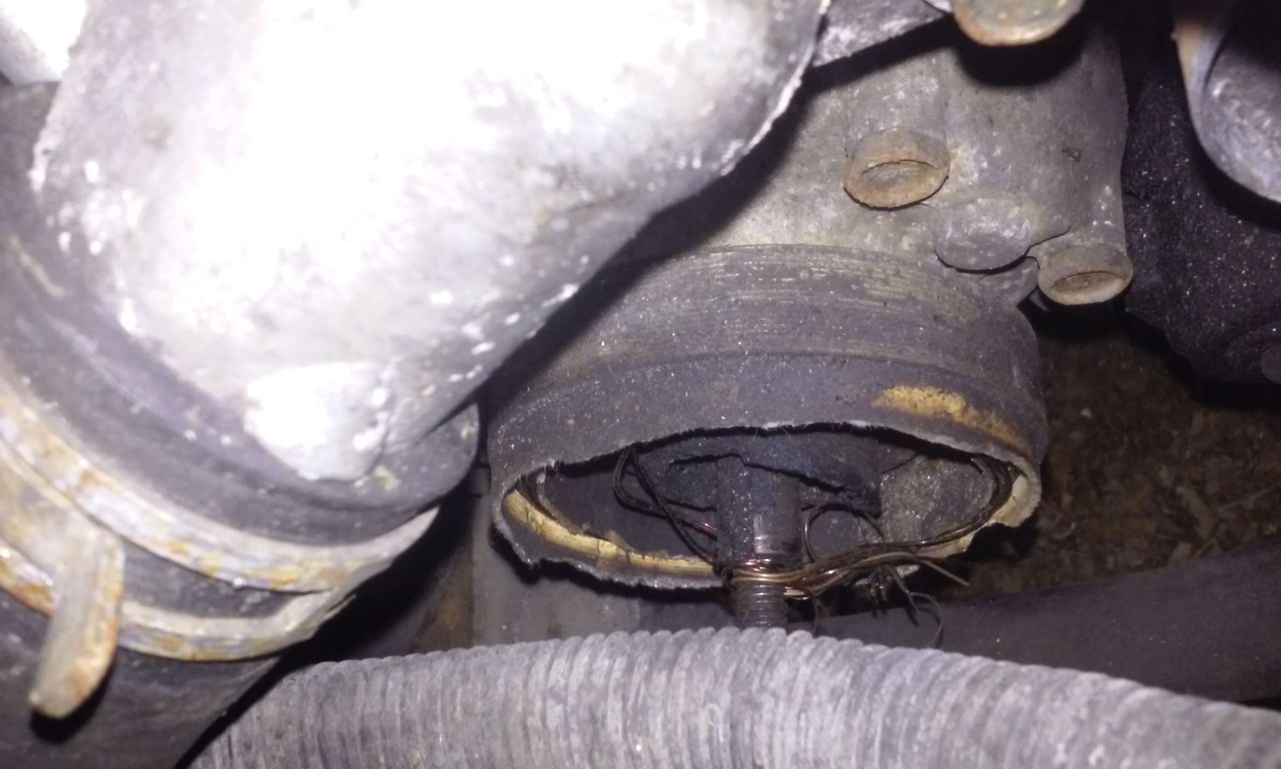

-the ac compressor literally looks like it exploded, check out the pic. in fact that entire belt that the compressor runs on is not there. can anyone tell me how that could have happened?
-i looked over the entire car and the only rust i could find was at the base of the radiator and the very front of the hood near the hatch release. it was only surface rust at that and it hadnt really made its way very deep into the metal or spread very far. my 93 has this same rust but a bit more extensive. i even pulled up the carpet on the passenger side foot well and it was dry as a bone.
-the interior has the usual wear and tear plus some, specifically the leather seats are torn to hell. the dash pad is completely missing but thats ok i can pull the good one from my 2002 for her. ebony leather door panels in awesome shape. carpet is ok. console is good aside from one spot that i really dont even know how to describe, it kind of looks like it either cracked or had a hole open up and someone used some kind of maybe putty to fill it and painted it to match but they did a horrible job. sound system sounded great with all speakers and the hatch speaker working good. trunk hatch struts brand new apparently
-paint as you can see in the pictures is rough and on the driver side quarter panel near the door its down to the bare metal. im not really concerned about the paint though.
-the guy said the transmission slips in 3rd and 4th. He took it out with the intention of having it rebuilt and he said a shop quoted him around 600 to do just the rebuild with the reinstallation done by himself. He had lost his job and needed money so he obviously couldnt move forward. Now.. heres the thing. He said the lady he bought it from(about 6 months ago, it was slipping from the time he bought it) had the transmission rebuilt once before.. so this would be the second rebuild. Im thinking that either it was shoddy work or possible abuse.. im thinking that maybe buying a remanufactured 4l60e might be my best option. What do you guys think? Should I gamble on the one ive got now or just be done with it getting a reman?
if i do get a reman.. im definitely interested in one without a core charge because im hoping to be able to keep this one and be able to disassemble it and hopefully attempt to rebuild it myself just for experience. ive looked at a few websites selling remans.. but im unsure what the best means for obtaining one might be. anyone have experience buying one online? should i just call around to local junk yards? is there a better option that im unaware of? a quick google searching shows websites like this Camaro 1998 - 2002 4l60e Rebuilt Transmission with LS1 Motor - RebuiltTransmissionSupply.com but are websites like this legit or are they to be avoided? im not necessarily looking for a performance trans.. though if there is any kind of upgrade to reliability that can be done i might be interested in something like that.
i was also thinking of having an oil analysis on both my 93 and the 98. have any of you ever had one done? you think its worth the couple bucks?
anyways, thanks for reading and thanks for any input. i know its not optimal info and one cant definitively say for absolute sure but good deal? bad deal? did i just throw 2 grand down the drain? any comments? if this is going to be an expensive lesson to learn in buying junk.. id rather know sooner than later lol

you know what? it just dawned on me. the air lid was probably damaged because the guy removing the transmission didnt remove it before taking out the trans. you guys think thats where that damage came from?

if they were driving with a slipping trans then it no doubt overheated and expect to replace the torque converter as well as some hard parts. That rebuild will run over $1,000 even for a bench rebuild. That is without labor to re-install the trans or the 12 quarts of fluid you'll need. You may as well go with Dex VI (6). It costs more but is better against wear and friction.
As for the air lid, I can't imagine how dropping a tranny could effect the lid up in the nose of the car.

Get the new AC compressor and dryer from Ebay. You can get them both for well under $200 total. You can't be living near UF without air conditioning.
