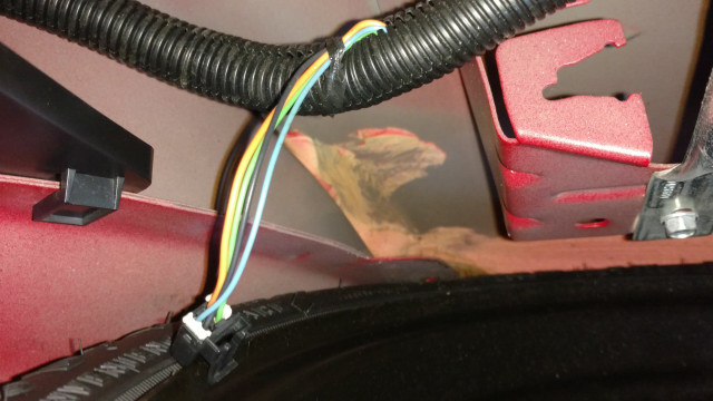

So whats this connector by the antenna. Its NOT for a power antenna because camaros never came with one.

Might be a body sensor for the security system. The plug looks kinda like it.

You are the man. Thats it. I checked the orange wire when the car is on and its 12vdc. Need to check when the car is off. I need that orange wire to power the antenna.

According to the service manual, the orange wire at the shock sensor socket is hot all the time, not just when the ignition switch is on. It is fed by the PWR ACC 15 amp fuse and a fusible link near the fuse/relay underhood boxes.
